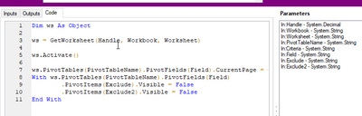

I created a code stage in my Excel VBO Extended to Select all then exclude certain values from the pivot table filter. However I am not a coder and would like to be able to pass in a variable no of values to exclude in a collection.
Here is my current code that excludes 2 values. But I may have 3 or 4 or 1. Please can someone kindly help me? Thanks.

Got it! Since you're using Blue Prism, you'll need to ensure that ExcludeCollection is properly passed as a collection in your Blue Prism workflow. Blue Prism collections work like tables with multiple rows, so you'll need to iterate over them inside the Code Stage.
Dim ws As Object
Dim pt As Object
Dim pf As Object
Dim excludeItem As String
Dim i As Integer
ws = GetWorksheet(Handle, Workbook, Worksheet)
ws.Activate()
' Reference the PivotTable and PivotField
Set pt = ws.PivotTables(PivotTableName)
Set pf = pt.PivotFields(Field)
' Select All Items First
pf.ClearAllFilters
' Loop through the Blue Prism collection ExcludeCollection
For i = 1 To ExcludeCollection.Rows.Count
excludeItem = ExcludeCollection.Rows(i).Item("Exclude") ' Adjust column name as needed
pf.PivotItems(excludeItem).Visible = False
Next iWould you like guidance on setting up the collection in Blue Prism?
