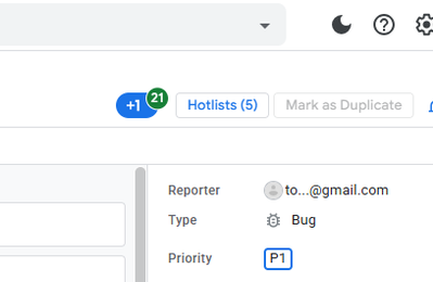

It might help to put some more pressure on the Chromium team.  If everyone clicks the ( + 1 ) button on the top right-ish of this page:
From Chrome 140+, multiple popup dialogs (e.g., Extension etc.) are detected via UI Automation tool [439716356] - Chromium
The +1 means: "I am also impacted".   You have to be logged in with a Google account to be able to click it.
