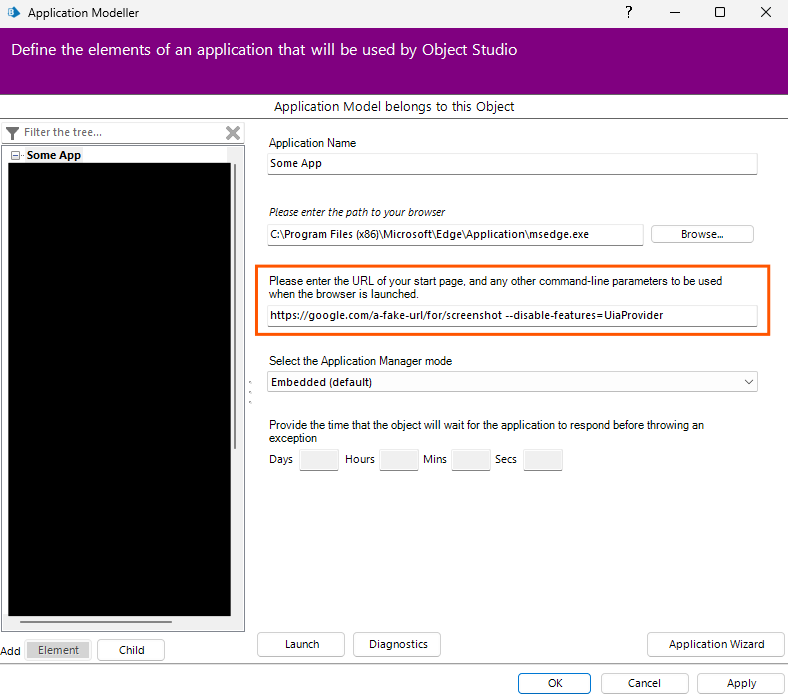

This can be a bit confusing, especially if you're not used to adding launch params. I'll show a few example screenshots below, but note that I am saying only one of these is necessary to do. It just depends on how you handle your automations and URLs.

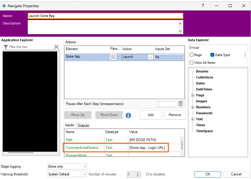

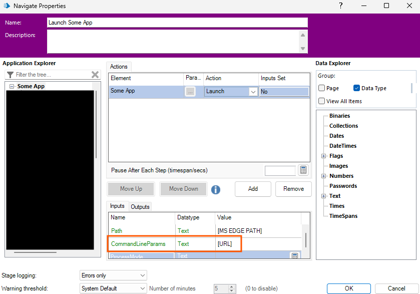

This assumes that you are using an environment variable and it is directly used in the object, and then the second screenshot shows using the environment variable directly in the Navigate stage that launches Chrome/Edge. I don't do this very often unless there for sure will never be multiple environments of the target app to be used in the same Blue Prism environment.
This is something you may want to do when just doing development. But also if you don't provide a URL to the navigate stage when launching, then it will use the value that is provided in the command-line parameters blank in Application Modeller.

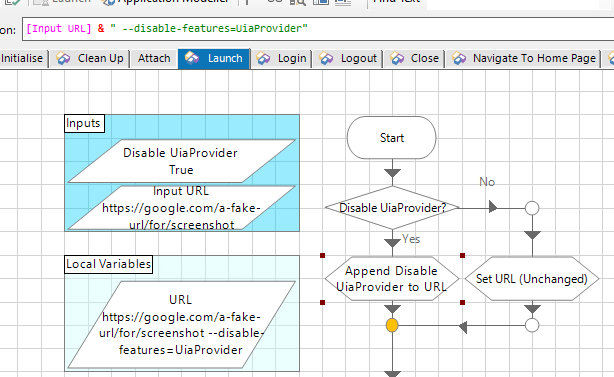

This scenario assumes that you have an input url parameter for your Launch action in an object. This would allow the process to pass in the URL it wants to use. This is super common for us because sometimes the same object needs to interact with different app environments in the same Blue Prism environment. We then also (or will) have an input for [Disable UiaProvider]. This will then be either an environment variable or a config param that is configurable in Production without a code change and is specific to the automation. This will allow us to turn it on or off per automation. Not everyone needs this, but it's an option.
And then the launch stage would look like this.

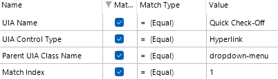

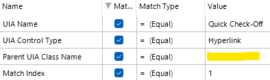

Example screenshots of an example we found that elements had to be re-spied. Screenshots provided by @SzymonWitek on our team. Thanks, Szymon! Note that the After screenshot below doesn't necessarily imply we will leave the Parent UIA Class Name selected but is just to show the change in attribute values.
Before:
After:
