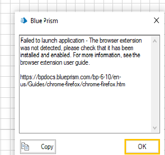

At present, I am using blueprism V6.10.1. When I try to launch an application through any one of the browsers(Edge and Chrome). Sometimes I am facing attach issue because of a browser extension and also I tried it multiple times. Even though I selected the browser Extension Connectivity option in the settings tab.
Failed to launch application - The browser extension was not detected, please check that it has been installed and enabled. For more information, see the browser extension user guide.
https://bpdocs.blueprism.com/bp-6-10/en-us/Guides/chrome-firefox/chrome-firefox.htm

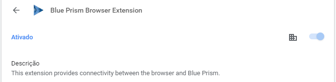

Can you validate that the extension is active?
Go to Settings-> Extensão -> Blue Prism Browser Extension - > More

Hi Emerson Ferreira,
Thanks for your suggestion. But, still getting the same issue again Even though it is in the active state.
