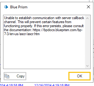

We also came across the below pop-up message after updating our machines to v7.3.1. in our test environment. This happens while attempting to run any process on a machine. After clicking Ok, i am able to see the pending session and start the process. Before the process runs, this popup shows up again and I have to click Ok again for the process to run.
Do you have any knowledge about this issue? We haven't seen this issue in our Dev environment during the upgrade process.
17-12-24 05:45 AM
This looks like some misconfiguration in your BP app server settings. Check your app server settings to see what you are configuring in the BP connection on the target machine. Look at the installation guide and follow the steps as mentioned.
