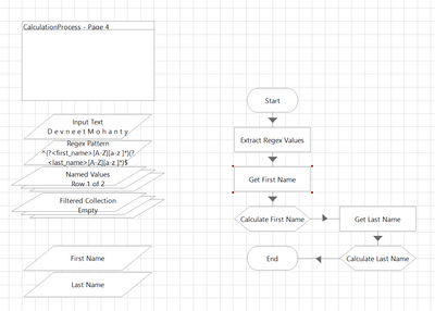

I built a sample workflow for getting these two data points out as shown below:

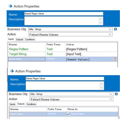

So first I am using the Extract Regex Values action from the Utility - Strings business object. Here you can pass the Input Text which you are getting out of PDF along with a Regex Pattern which should be as follows:
^(?<first_name>[A-Z][a-z ]*)(?<last_name>[A-Z][a-z ]*)$

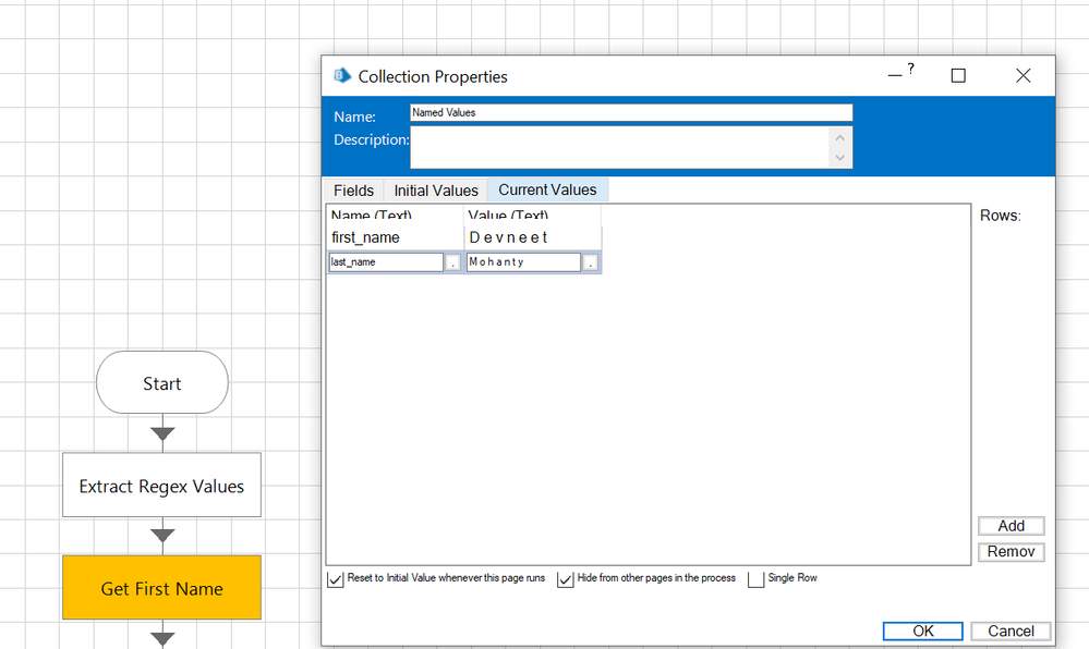

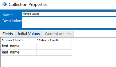

Also, we need to create a collection called Named Values having two fields of Text Type called Name and Value and we will initially add two rows such that the 'Name' field has the values: first_name and last_name as shown below:
Now, we pass all these parameters to our action and get the output collection in the same Named Values collection:
Now, when we execute this action, we will get the extracted values for First Name and Last Name in the Named Values collection as shown below:

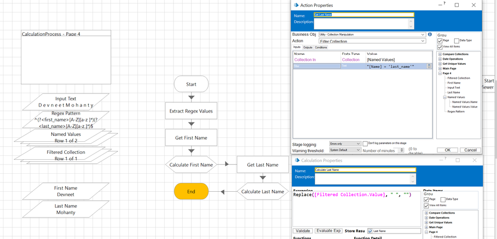

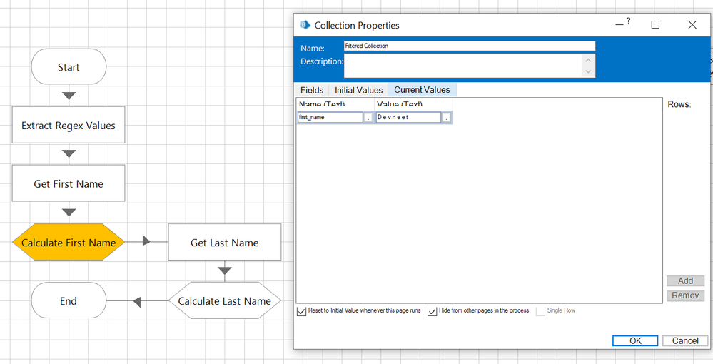

Now, we will use Filter Collection action which I have named as Get First Name and here I will pass the Named Values collection along with the filter query as "[Name] = 'first_name'" and store this value to the Filtered Collection collection:
When we will execute this action, we should get the Filtered Collection with only the row containing the 'first_namevalue:

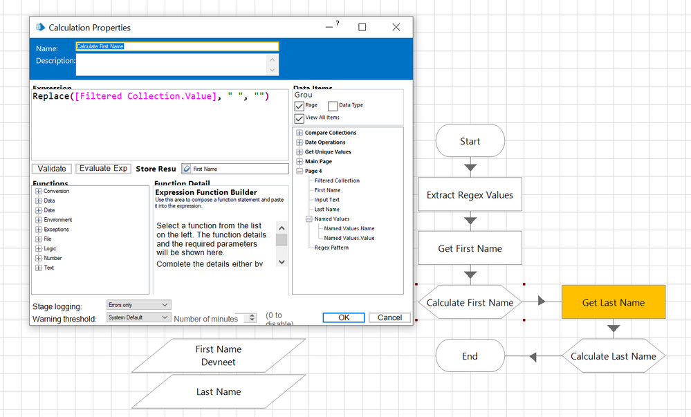

Now, we can use a Calculation stage and replace the space characters with an empty string and store it to the First Name data item:
Similarly, we will now use the Filter Collection action and calculation stage for the Last Name as well and we should be able to get the Last Name data item value:
