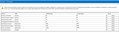

With version 7.1.2, even though the extension was installed, it was not recognized because it was still loading. This problem can be solved by increasing the standard timeout of the Messaging Host (for example, from 10 to 150). In our case, this solved the problem.
