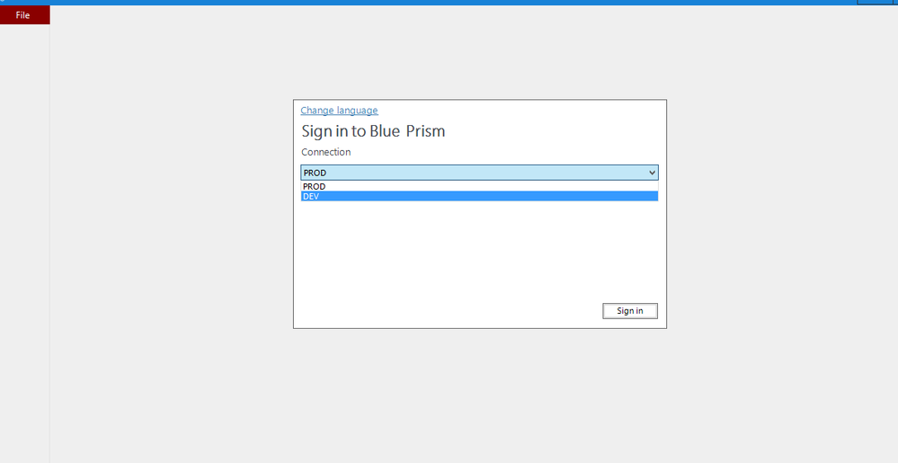

I am trying to sign in to Blueprism through command line switch /sso(Single sign on), but the requirement is to toggle between the Dev. and Prod. Environment, though it's not an ideal practice but i wonder if there is any way to do that.
By default it selects the environment which is at the top of the list.
Is there any way that we could switch/toggle between these environment through the CMD?

@UditKhanna,
Theres a switch called /dbconname that allows you to specify the database connection to use.
You can find out more about the various switches here:
https://bpdocs.blueprism.com/bp-6-10/en-us/helpCommandLine.htm?Highlight=Automatec%20
