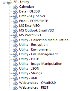

Can we change the default run mode of BP provided VBOs from Exclusive to Foreground?
We require to run background process on our machines, but since most of the running process uses BP provided VBOs that have the run mode set as exclusive, we are unable to do so.
We have the below VBOs in our environment:
Usually the MS VBOs Excel, Outlook, Work etc. have b as Exclusive, can we change that to Foreground or will there be any impact of this?

Hello @Manish Rawat,
You are free to change the VBOs as you see fit.
My own personal recommendation would be if you're going to change the run-mode of the standard VBOs, you're probably better off changing them to background. That's actually something we've started doing with most of the legacy VBOs that are hosted on the DX. This is why I always recommend people to pull the latest VBO from the DX instead of using what's included in the installer.
Yes, in fact, the versions that are on the DX (for Excel and Word) have already been changed to Background I believe. Outlook is still set as Exclusive because of the execution model of the Outlook client itself (you can't have more than on instance of the Outlook client running at one time).
