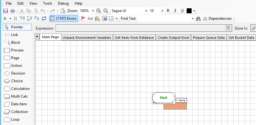

HI When my process is migrated from BP 7.1.1 to BP 6.4.1, I am facing following issue. Where all the stages are overlapping on each other in all pages.
Do we have any solution.?

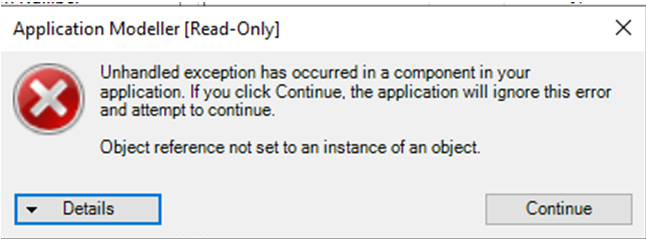

@ewilson,
It doesn't show any of the attributes in v6.10.1. When I go to view the attributes for the elements imported from v7.1.1 to v6.10.1, it gives this error popup:

@KunalDoshi2,
Glad you understood what I was asking even though I had the versions backwards. 😂 So this definitely an issue related to changes in the application model. Just to be clear, after you exported your VBO from v7.1.1 did you run it through the Compatibility Tools asset on the DX before importing it into v6.10?
