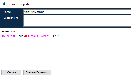

I have a decision stage, but for it to flow in the ‘yes’ direction, both statements need to be true. If I evaluate the expression with just [Success]=True and test it, it works fine. But I was wondering if I incorrectly wrote this because it returns False no matter what combination I change the flags to be:

Hi @GracieDevine1
Is a syntax problem. The ampersand is used to concatenate strings, not as a logic gate (and).
You need to indicate this:
[Success] = True and [Emails Success] = True
And, is more clear if you only put this:
​[Success] and [Emails Success]
Without = True, cause the Flag is true, not need to compare it.
Hope this helps you! And if this solves the problem, remember mark as the best answer!

GracieDevine
Hi @PabloSarabia
​Thank you so much 🙂
