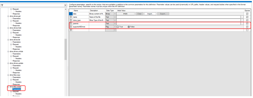

Hi Disha,
Going through this thread, I think that Eric is trying to say that you can add these additional input parameters in your Web Service setting as show below:
Step I: Add the additional parameters under the 'Parameters' section of the action 'drives.files.create':

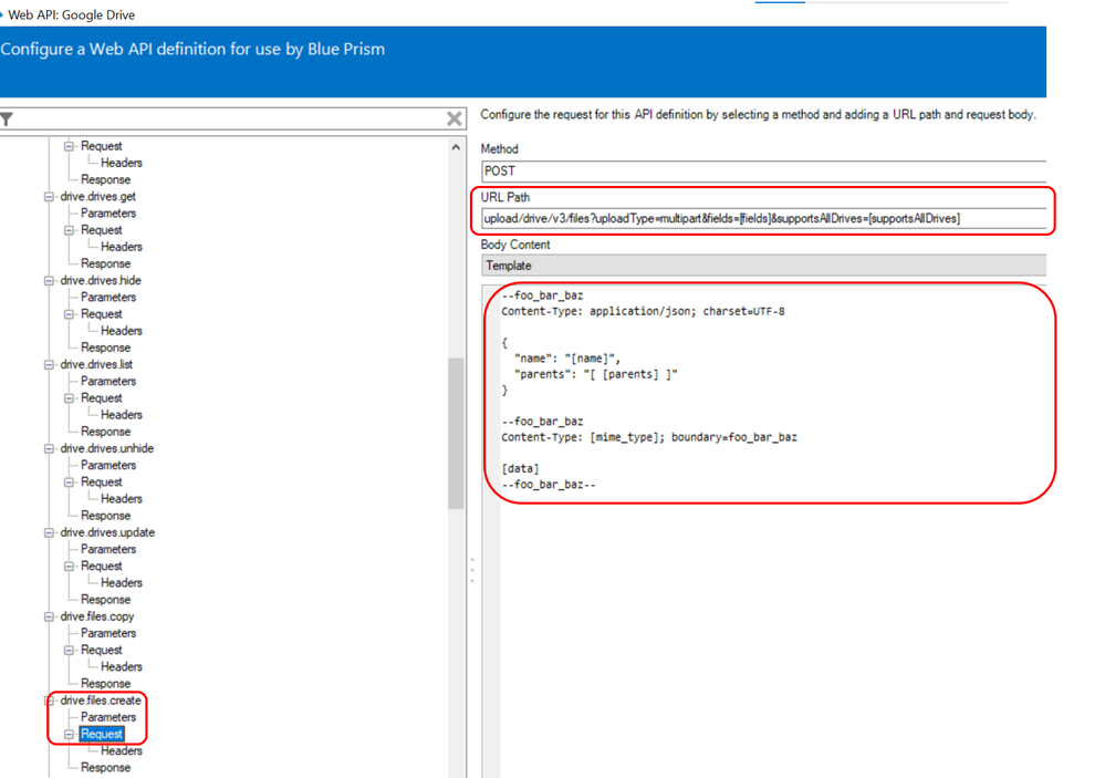

Step II: Make the changes in your request definition under the 'Request' section of the action 'drives.files.create':

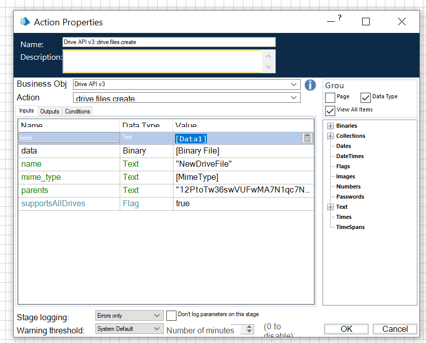

Step III : Once you save the changes, access the same action from Process Studio and pass all the parameters in your action:

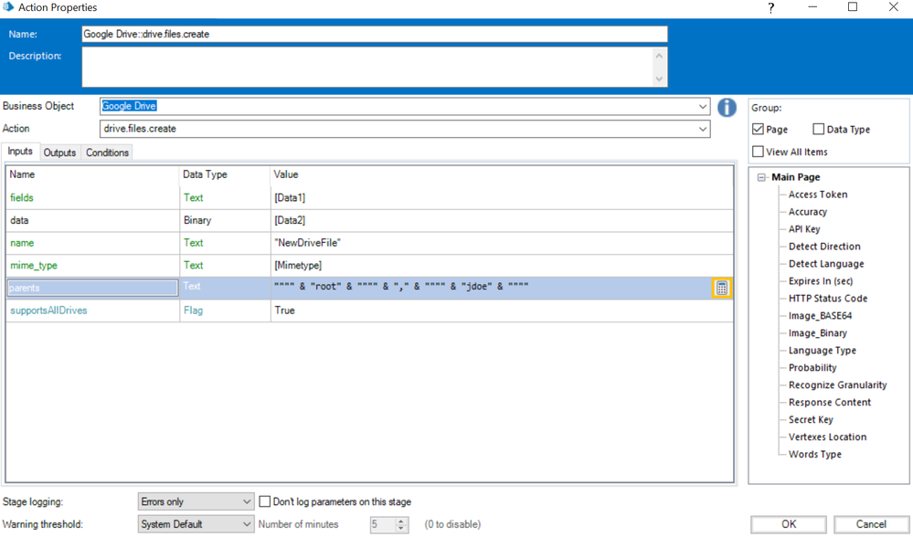

I configured everything you stated above
Let's say I have one parent and my parent id is xyz
This is my action stage configuration

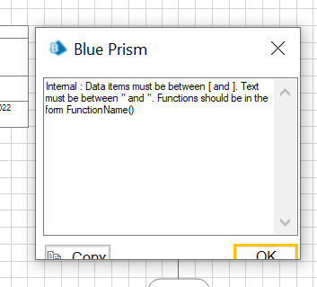

And the error I am getting is
Which configuration is the mistake?

Hello Disha,
Can you check once for each of the parameter, if the syntax is correct or not. You can do this by clicking on the Calculator symbol beside each parameter one by one and the when the Expression wizard opens up, click on the 'Validate' button. That will help you to isolate the issue like at which parameter you have any issue.
You can show us the exact parameter value where you are getting this error that way.
If there is an error with the expression, then upon clicking on the 'Validate' button, you will get the same exception message:
My guess is your issue lies with the 'Parents' field although I cannot tell for sure as the entire text is not completely visible in your screenshot.
