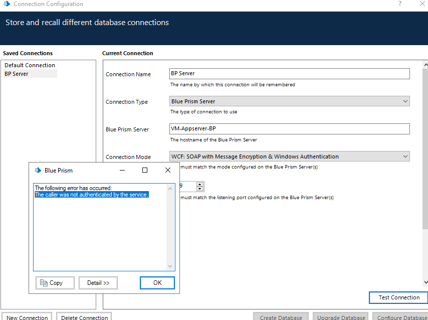

We are setting up Production Environment. We have installed BP6.9 enterprise version in VM1 as application server, In VM2 and VM3 as Runtime resource's and in VM3 as Interactive client(controller). We couldn't establish a connection between RR,IC with App server, getting an error like The caller was not authenticated by the service when tested bp server connection. we are trying to resolve the issue.

Blue prism service working fine in application server. But not able to conduct BP server test connection successfully in RR/IC getting an error The caller was not authenticated by the service . Even tried with Start: "C:\Program Files\Blue Prism Limited\Blue Prism Automate\BPServer.exe" still getting same issue

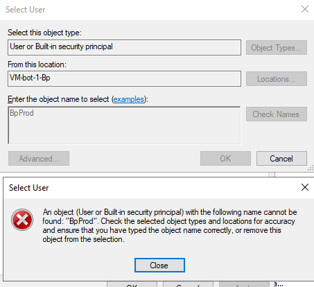

 We got a support from Blue Prism Team saying that we need to create a service account in azure sql DB as we are setting up blueprism prod env using  cloud. But we are not able to create such account. We have created a user/login account in azure sql and tried to use in services >bp server> properties>logon> but username is searching from available VM location.
can u suggest us  how to resolve? it will be very helpful for us.
