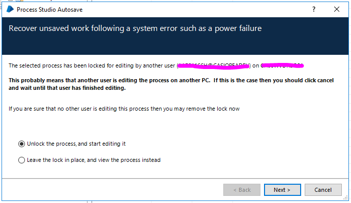

Hi Sri Hari,
The locked state of the process usually comes into the picture if the process instance has been was locked for editing by someone on the BP server in process studio. The lock will not be removed until the user release the process or someone force unlock the process/object. You can try to check in the studio if the process is locked by any user and then ask the user to double click on the process and then close it safely. It will unlock the process.

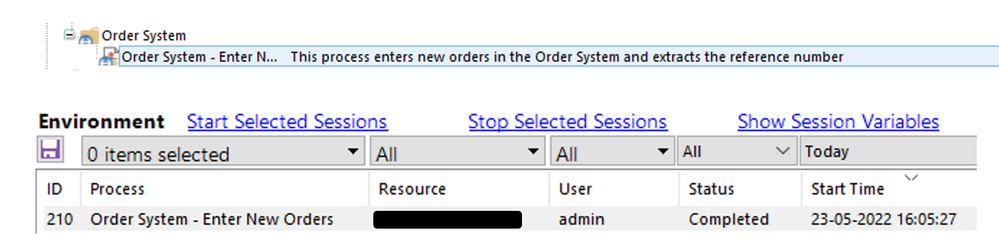

However, the strange thing is that even if your process is locked then also it does not affects the session executions in the Control Room. You can see here that I was able to run the process even when it was locked in the Process Studio:
Can you tell us exactly what error are you getting while trying to run the process

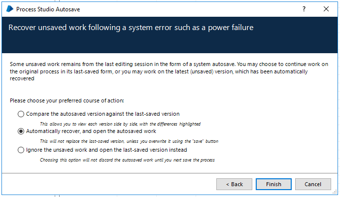

Did you try opening the Process and unlock it.
When you open the Process, you will see this pop up:
Click on next, and then select the option to recover that you wish:
Then save the process and try it again.
Hope this helps you!

23-05-22 12:31 PM
I too tried the same. Lock on the process does not cause the session to not trigger.
There must be something else that caused the scheduler to not trigger the session.
