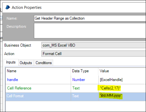

Hi Eduardo
You should be able to use the Excel - VBO Format Cell action to directly amend the format type in the cell. In the input parameters set the cell format to "dd.MM.yy" and provide the cell reference you want it applied to. In this scenario I would normally find the starting cell and the last cell I want to format and apply the format to the entire range rather than doing individual ones with calculation steps to keep the process simpler eg. "A2:D2".

You can use the Format Cell action of MS Excel VBO to apply the correct format for Reversal Posting Date column and then use the calculation stages as done for other 3 scenarios.

​Thank you, @shashank.kumar280 and @Michael ONeil
Format Cell can be used in Excel BO in BluePrism
Thank you everyone, it works, but the sheet is not recalculated and the new format does not appear until I save, close and reopen the file.
(I need to go to cell that changed, press F2 to edit and press Enter, then it gets re-calculated and shows the new format, dd.MM.yyyy).

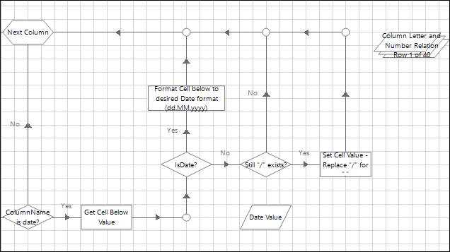

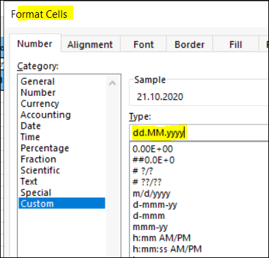

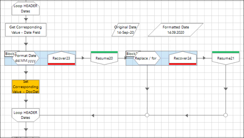

I believe this is the best and fastest approach: select whole range and format it to desired DateFormat in a single action.
Before, I was checking row-by-row if it is DateFormat.
If it is DateFormat in Excel, change to dd.MM.yyyy.
If it is a Text, then replace "/" to ".", as in "30/09/2020" to "30.09.2020".
If it is NumberFormat, then formatting in excel to DateFormat (dd.MM.yyyy) would also work.
Whole range formatting (the best approach) can't be used if some cells are text, because it would turn them into ###########.
Obs: VERY SLOW to check row-by-row as above when 100's rows to check and format.
