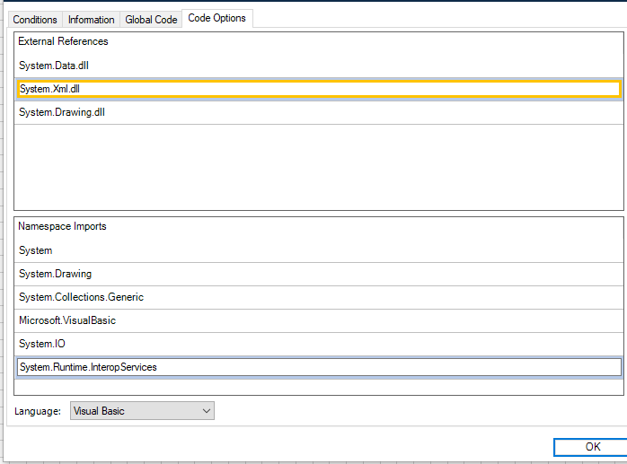

I think that BP is not recognising the Paragraph data item cause you don't have added the Interop dll
Try checking this configuration for the VBO:

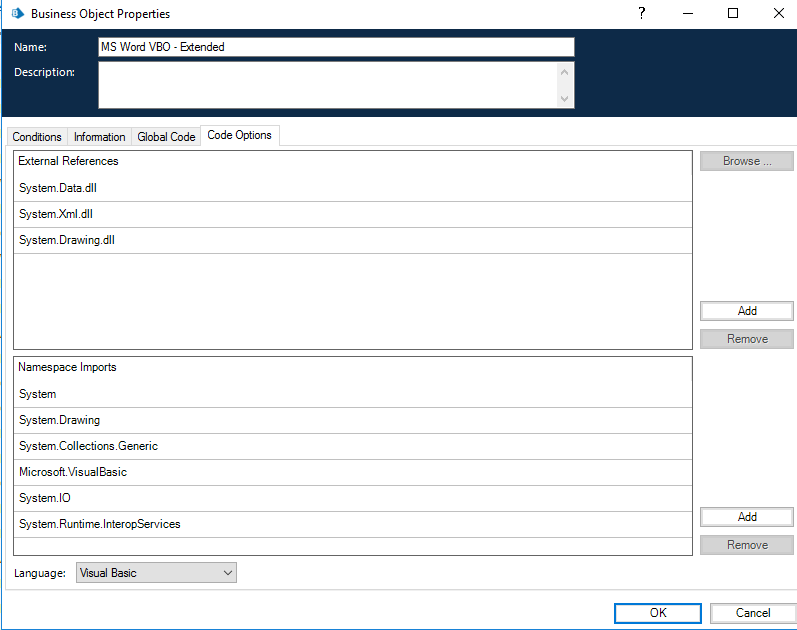

Thank you @Pablo Sarabia! I was created this custom action within the Microsoft Word VBO as you mentioned. This is what my configuration looks like in the Word VBO:
18183.png​
I believe this matches your picture, correct? Or is there anything else I need to change within this configuration? Also, I'm using Word 2010. Perhaps this interop dll is not compatible with Word 2010?

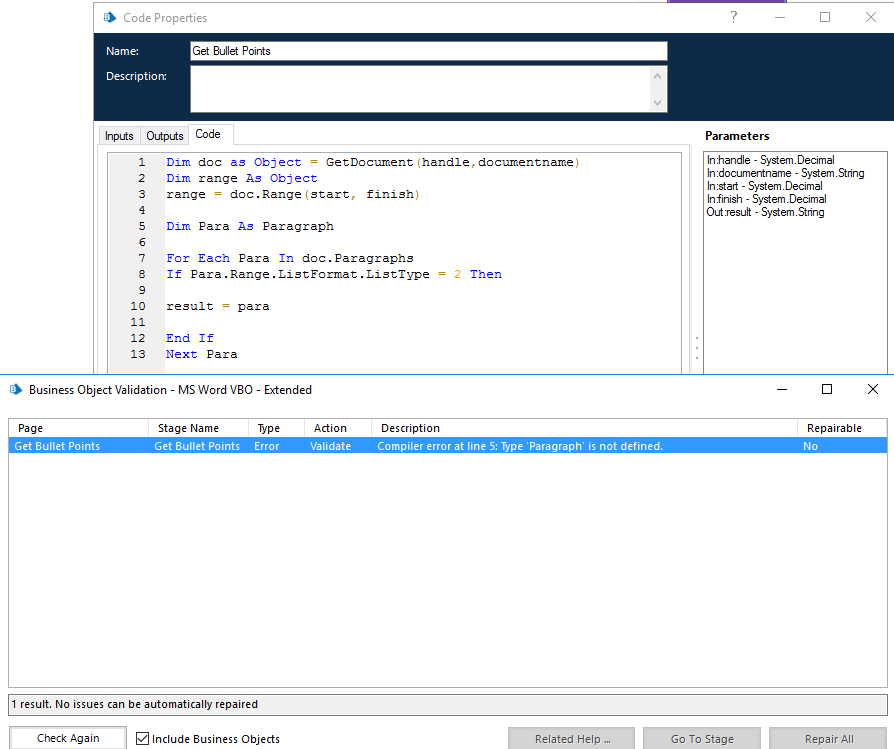

Hey, @PabloSarabia, this is the error I'm getting. I had to make a couple adjustments to your code because I was getting some additional errors, but now I'm just left with this one error that I'm not sure how to resolve. Do I need to create an input for Paragraph?
Thank you.

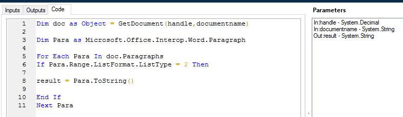

Hi Sean,
Try using this code at line number 5. It should ideally work:
Dim Para As Microsoft.Office.Interop.Word.Paragraph​

Thank you, Devneet. I updated my code and am no longer getting an error, however, the output I get is "System.__ComObject"
Here's the code I now have:
I believe I need the .ToString() in the result or else I'll get an error, however, this is causing my result variable to have an output of "System.__ComObject"
I feel like I am pretty close to getting this and just need to find a way to get the values in the output.
Appreciate your help!​

Hi @Sean Scudellari
To get the text from a paragraph use this:
result = Para.Range.Text​
But, with this you only get one of the texts. Do you want to get a collection of all the texts or something similar?

Thank you @Pablo Sarabia! That worked! But yes, getting each bullet point within a collection would be great.
