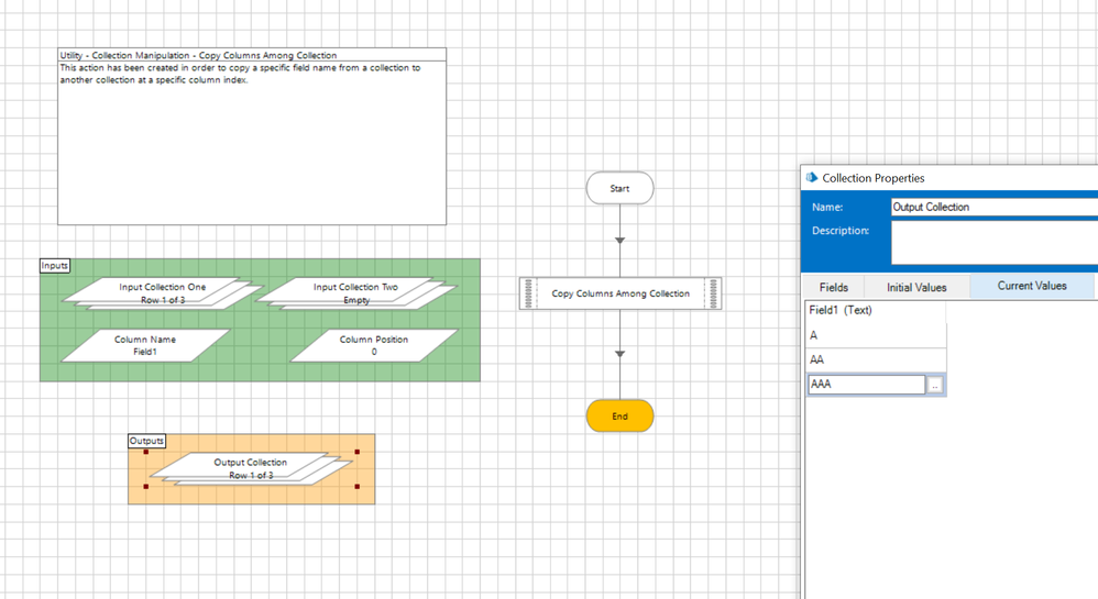

Hi @Jan-HendrikLieb
I created a custom object few months back for someone in the community which I can't recall. There was this action I created called as 'Copy Columns Among Collection' where it was primarily used for copying any specific column from an input collection to an output collection at any given position starting from '0'. I have attached the sample business object for your reference but if let say you are unable to import the attached file due to any organizational policy or compliance restriction, then in that case let me show below how you can create a similar action below:

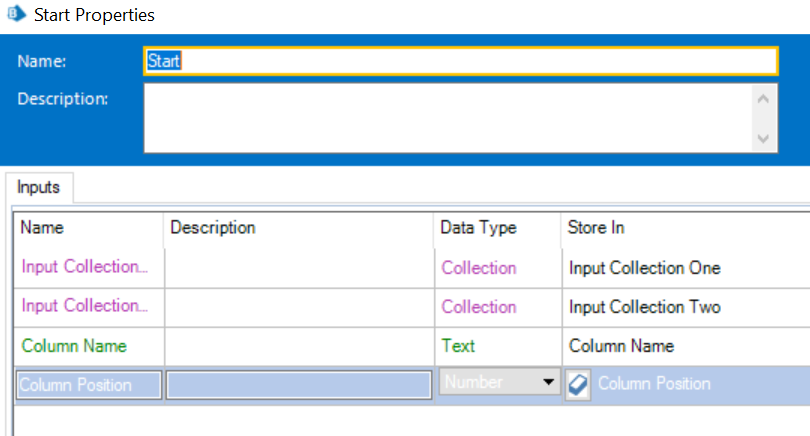

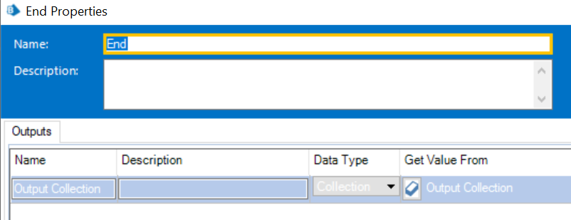

First, extend the business object named 'Utility - Collection Manipulation' VBO and add an action called as 'Copy Columns Among Collection' where you need to use the following input and output parameters:

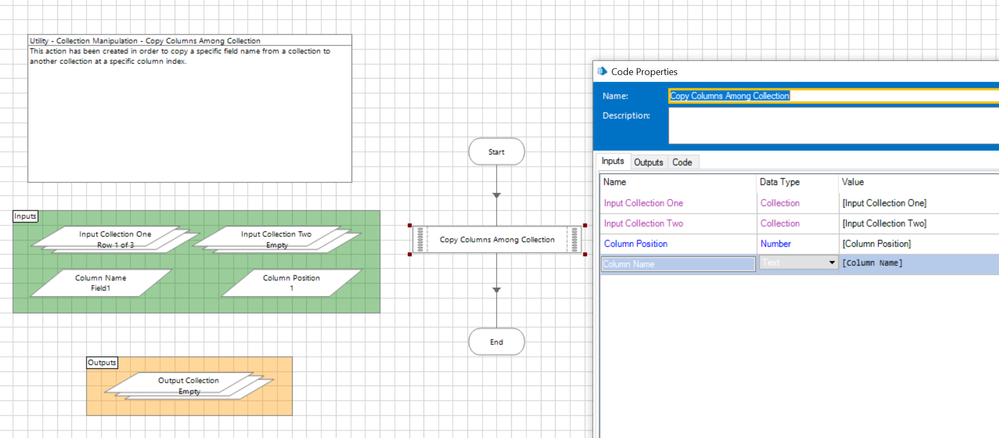

Once you have mapped the parameters to individual collection and data item stages, you need to add a code stage as shown below:
Code:

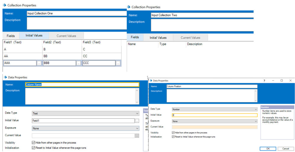

Now, you can test the workflow with the following inputs:
Note: If you wish to copy the column to an empty collection then the column position will always be 0 otherwise you will get an exception. This action can be used with any kind of collection empty or filled, you only need to ensure that proper column position is passed which actually exists in the target collection where the column needs to be copied.
Once you run the workflow, you get the following output:
You can test the logic with different scenarios and you should be able to get it working. Please let me know in case of any further issues.

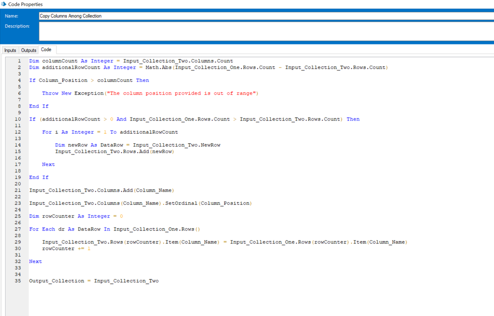

Code:
Dim columnCount As Integer = Input_Collection_Two.Columns.Count
Dim additionalRowCount As Integer = Math.Abs(Input_Collection_One.Rows.Count - Input_Collection_Two.Rows.Count)
If Column_Position > columnCount Then
Throw New Exception("The column position provided is out of range")
End If
If (additionalRowCount > 0 And Input_Collection_One.Rows.Count > Input_Collection_Two.Rows.Count) Then
For i As Integer = 1 To additionalRowCount
Dim newRow As DataRow = Input_Collection_Two.NewRow
Input_Collection_Two.Rows.Add(newRow)
Next
End If
Input_Collection_Two.Columns.Add(Column_Name)
Input_Collection_Two.Columns(Column_Name).SetOrdinal(Column_Position)
Dim rowCounter As Integer = 0
For Each dr As DataRow In Input_Collection_One.Rows()
Input_Collection_Two.Rows(rowCounter).Item(Column_Name) = Input_Collection_One.Rows(rowCounter).Item(Column_Name)
rowCounter += 1
Next
Output_Collection = Input_Collection_Two
