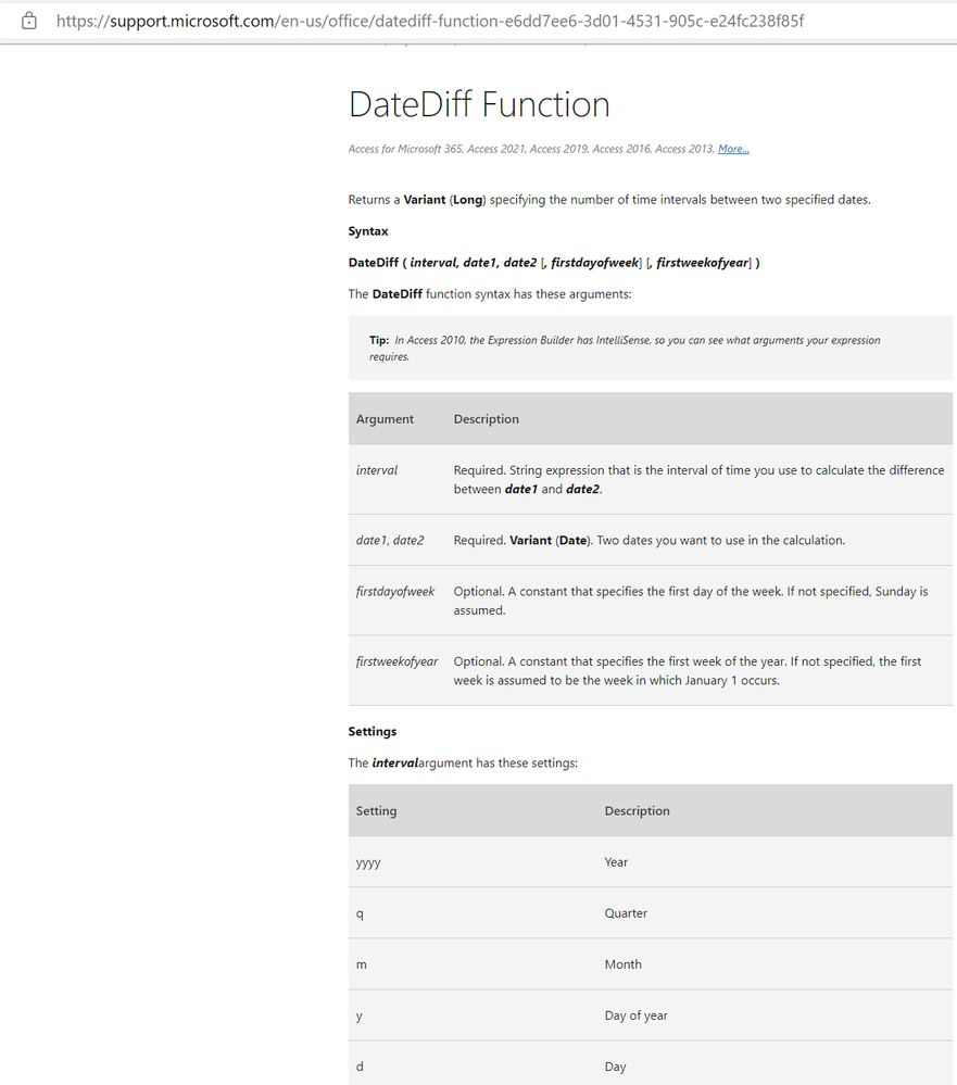

What exactly is the difference between Interval 8 Day of year & Interval 9 Day. Please elaborate
Swapnil Puranik
Hi Swapnil.
In reality, both of these intervals actually provide you the same result which is the unit of difference in terms of day. The reason why we see both these intervals is because when ECMA standard framework languages were developed by Microsoft such as VB .NET, C# and VBA, DateDiff method had this definition by default. My guess is somewhere they wanted to change the metric or the unit in which the value was supposed to be returned but, in the end, they stuck with the same metric of day which got returned while using both the parameters.
Since Blue Prism uses these languages in its internal framework while generating classes and calculations, they also used the same method definition somewhere down the line.
You can see below all the valid date formats we have with this class as per the MSDN documentation:
Also, there are references in DBA stack exchange as well which state the same reasoning as I provided you though it is for MS SQL server but again that also is built on same ECMA standards as all the other languages I stated earlier: t sql - SQL Server DATEDIFF: How's dayofyear different from day? - Database Administrators Stack Exchange
