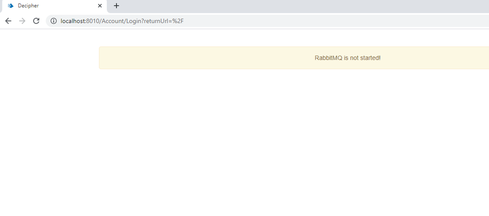

I followed all the installation steps, but when I tried to access decipher I get a sceen stating:

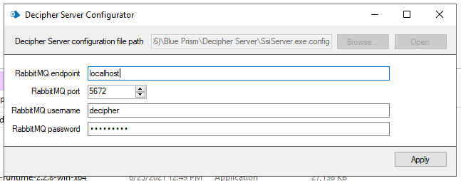

I ran the DecipherServerConfiguration tool and verify the username, still the "guest" user is trying to connet to the RabbitMQ, with the wrong credentials
"RabbitMQ is not started!"

19-07-21 07:56 PM
The decipher screen when attempting to login is as follows,
yet the RabbitMQ is running, with the valid user and the (not shown) queue created by the installation process.
