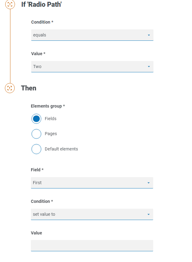

Hi Zdeněk
Here is an example where, depending on the value of a radio button, a subsequent field has it's value set to blank. I've just tested this and it does clear the field if you change the previous answer. I hope this will satisfy your requirement to have the logic in one place, but it does mean adding more rules in your form. Is this of any use?
4035.pngThanks

Hi, Joe,
if the field "First" is mandatory then it won't allow you to leave the Value empty. Try it. At least in version 4.2 I can't leave it empty.

Hi Zdeněk
You are correct, in my rule set the field's initial stage is set to hidden and only becomes mandatory based on a previous answer. Are you trying to change the state of a previous answer based on a subsequent question?
