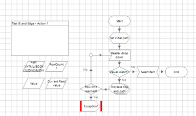

If you are still having an issue with this selection the item using text or position or both then I would suggest using a dynamic path to select the item you need. This is done by changing the path in application model to dynamic and this way you can edit it in a data item and pass it as a parameter of a read action. For example the path might look something like this /HTML/BODY(1)/DIV(19)/DIV(2)/DIV(1)/DIV(2)/FORM(1)/TABLE(1)/TBODY(1)/TR(1)/TD(2), generally you only need to change the row using a calculation stage /HTML/BODY(1)/DIV(19)/DIV(2)/DIV(1)/DIV(2)/FORM(1)/TABLE(1)/TBODY(1)/TR([RowCount])/TD(2). After you set this use a read stage with the drop down element and set the parameter in here with the path data item.
20337.pngUsing a decision match the value you are looking for the value read if it matches select that item using a navigate and setting path data item as the parameter. If they don't then increase the row count and edit the path with a multi calculation stage and retry the read. Important to remember to limit the number of time this iterates, if you know the number of items in the drop down list using a decision to check if the row count is greater than that number and if so then end or throw exception otherwise you'll end up in an infinite loop. Example diagram below
