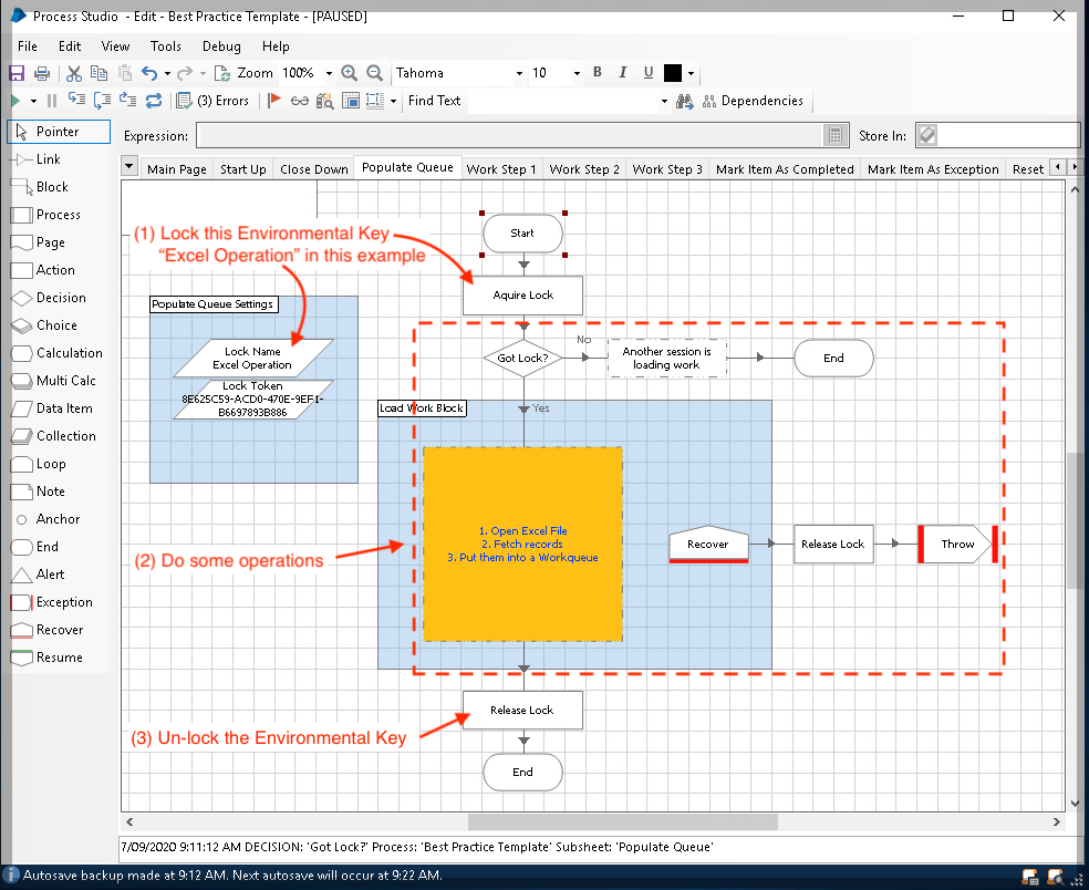

Hi Shubham,
> how will this work I want to have the understanding of this,
I believe you are asking how "Environmental Lock" works in your situation. If so, Blue Prism Locks an Environmental key while the first process is running and leases the key when the it's done. Please be aware that Blue Prism does NOT lock the Excel file. See the following example.
You can check the status when the Environmental key was lock in "System" --> "Environmental Locks".
In this logic, the second process can't Lock the environmental key when it was locked (When the first process was still working). Therefore, you can make sure that only 1 process accesses to the Excel file. I attached the process (BPA Process - Process Template 1 - Basic.xml) just for your reference.
If you are asking other things, please let me know.
