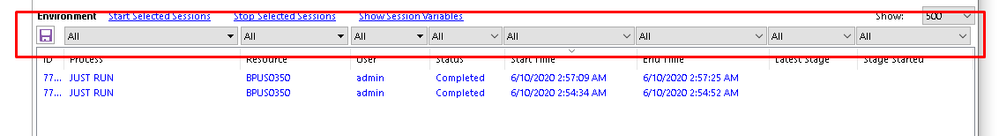

Please check if this Runtime Resource is not busy or have another process pending, maybe from a day before.
Make sure the filters in the Control Room are select to ALL.
This will help you to locate any pending process in past days.
