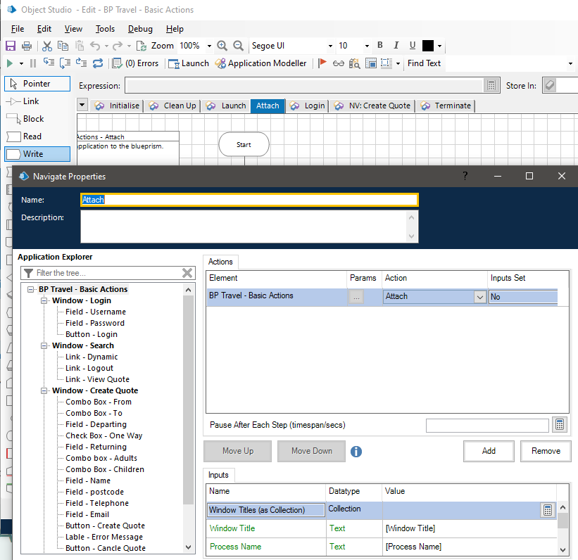

I am not able to Link Notepad object with Launch page.
I was doing the training on:
Blue Prism Foundation Training > Section 5 - Business Objects
In the video @ 02:00 when it shows that you created the new object (Notepad) and it opens the object, the object has Launch, Close, Write tabs but it didn't showed how those tabs has been added.
Also in the video when it directs you to open Launch tab at 02:43, but it didn't told you how did the Notepad is attached to Launch (Navigation).
Thanks,Launch (Navigation) how to link Notepad here.Launch (Navigation) how to link Notepad here.These options are already there.These options are already there.
