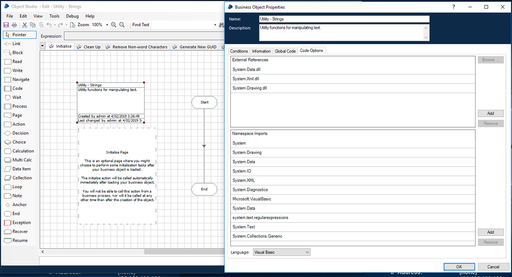

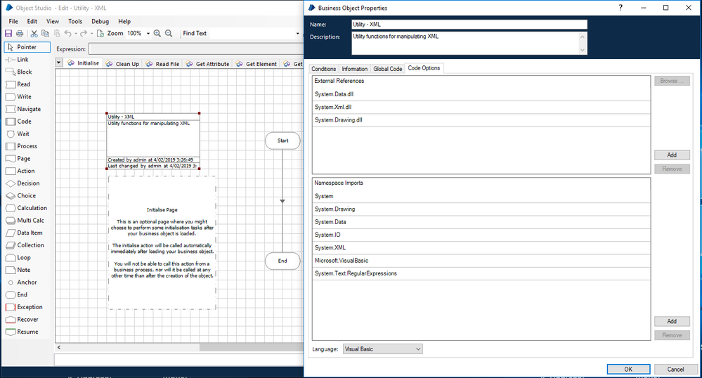

I am facing errors in Utility String and XML. You can check the attachment for reference.
I have compared code, Namespaces, DLL's with same utilities in another PC. All are same.
But I am not able to understand how to resolve. Can someone help me out.
Thanks in advance

Hi Vinod,
The code compiler was updated in version 6.8, so the syntax is slightly different for code stages. It sounds like this could be the reason for the validation errors you are seeing. Can you confirm that the VBOs are up-to-date and correspond to the version of Blue Prism that you are using? Have you tried re-importing the VBOs?
More info is here, see issue ID BG-6930 (Code stage compiler update may cause errors in the VBOs that are shipped with Blue Prism):
https://portal.blueprism.com/customer-support/support-center#/path/Upgrade-Expansion/Upgrade/1490225772/What-are-the-known-issues-in-Blue-Prism-Version-6-8.htm

Hi Vinod,
If you using Blue Prism Utilities, please ensure they have below DLL in Business Object Properties > Initialize > Code Option
If you use your own code stage, you need to define your DLL in Business Object Properties > Initialize > Code Option

Hi Hossein Azimi ,
Thanks for the reply. The DLL's which were mentioned by you; are actually defined in Business Objects, I didn't use any own code. But still facing same Issues.
For reference you can see the attachment.
At Present problem got resolved temporarily, when I deleted respective DLL's from "C:\Program Files\Blue Prism Limited\Blue Prism Automate".
Still I don't understand Why I got such errors before deleting DLL's.
