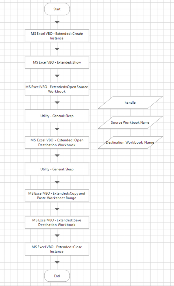

Hi Filipe.
Can you try putting some delay after opening each of the workbooks using 'Sleep' action from 'Utility - General' VBO as shown below. Also, ensure that you use the 'Show' action as without this from Office 2013 onwards there are some issue that happens while using this action in the background mode:
Website: https://devneet.github.io/
Email: devneetmohanty07@gmail.com

fgaia
Hello, @devneetmohanty07!
Sorry for taking too long to reply. Thank you for the answer!
In my case a coworker found out that there was an error on the object code, we fixed it.
And yes, the 'show' activity is very important when using 'copy paste' activity, I hope your reply can help someone having this problem in the future 🙂
