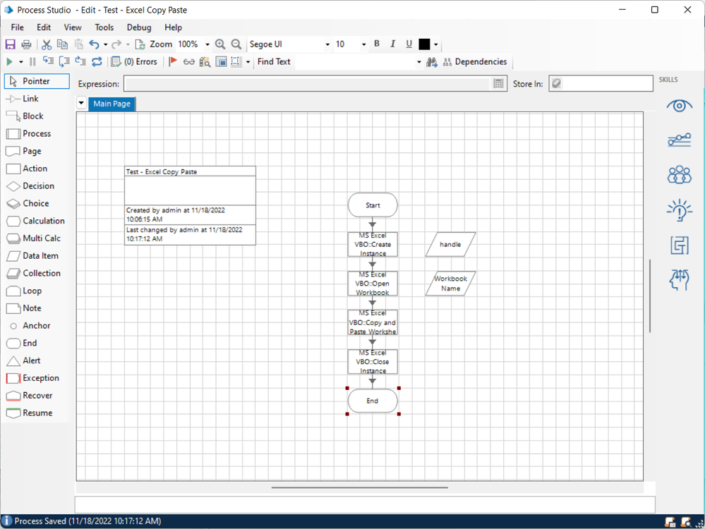

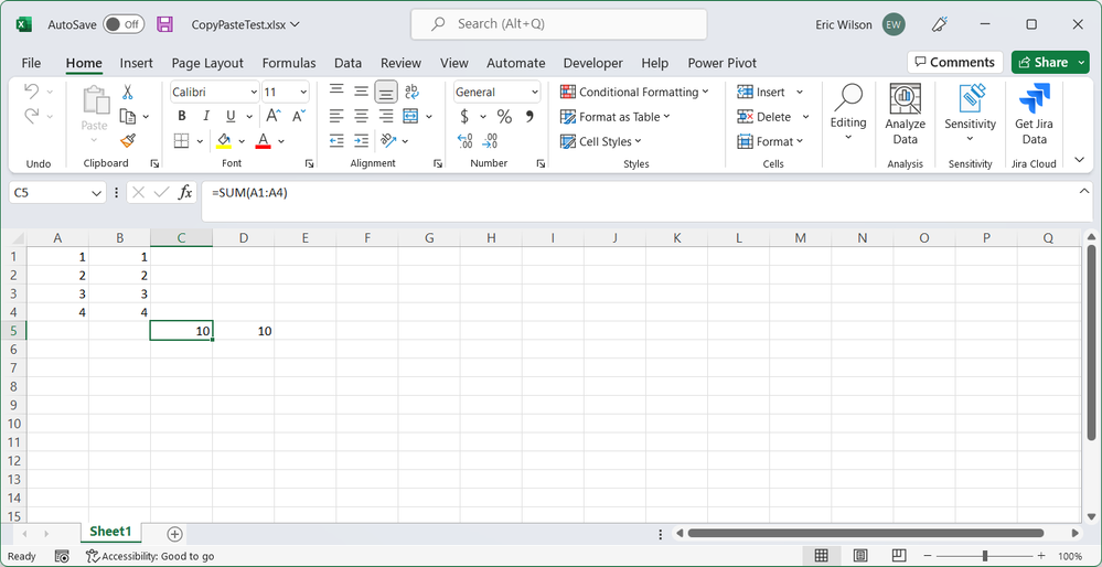

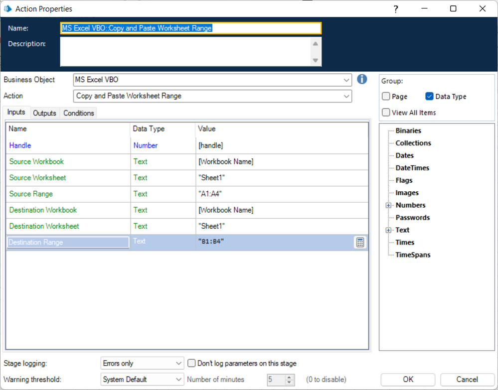

I think it might be best if you can paste some screenshots to let us see how you've configured things. I've run a quick test, but I'm not seeing the issue you're having. Here's the test spreadsheet I threw together and the simple test process.
I was able to copy the range A1:A4 into the same workbook and worksheet as range B1:B4. I was also able to copy the formula in C5 over to D5.
