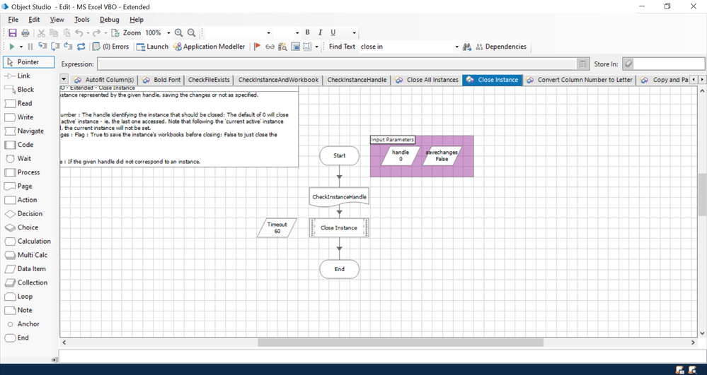

Hi @TruptiKorade
Have you tried extending the timeout period on the close instance action? I have several processes where the files are very large and take a while to close so I have the close instance set to a longer wait time to allow them to close without error. You can do this in the close instance action as the timeout period is a data item, no messing around the code. Just open the excel vbo>close instance action and then open the Timeout data item and increase the value to the desired period. (See screenshot below). Hope this helps 🙂
