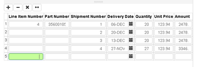

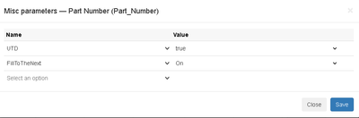

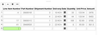

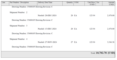

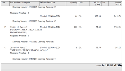

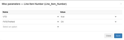

I am trying to extract Purchase Order PDF where the Line Number and Part Number fields are not mentioned in each row if it is same for the subsequent rows. Only the Shipment Number and other details will be mentioned in the next rows. I am attaching the screenshot of 2 pdf's. I have used "Fill to the next" miscellaneous parameter in Line Item and Part Number column of DFD to fill the previous row data to the next rows. Also, I have used "UTD" Miscellaneous parameter since it is not in the regular tabular format.
The problem is "Fill to the next" is not working. Attached data verification results.
PDF 1:
Page 1:
Page 2:
Data Verification Result:
PDF 2:
Page 1:
Page 2:
DFD:
