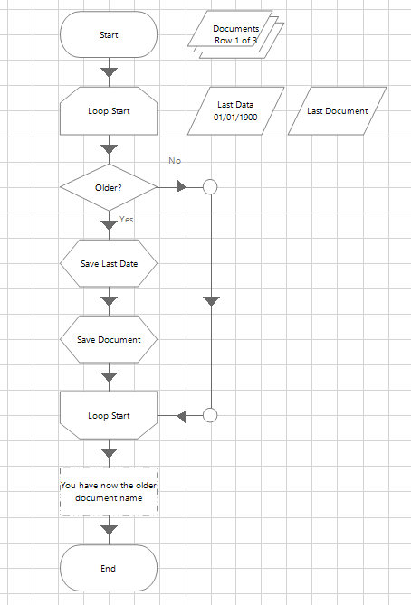

Here you have a quick procedures to make this:
For the latest:
- You have a collection with all the documents and dates (Two collumns, Document and Date).
- Need to initialize the date variable. I set it to 01/01/1900
- Then, you make a loop iterating the collection row by row.
- With a simple choice you decide if the new data of the row is greater than the date that you have storage in the "Last Date" data item.
21430.png- If is older, you save the document's name and date. (Take care, case if you have two documents with the same date, you only save the first, is greater than > , no greater or equal than >=)

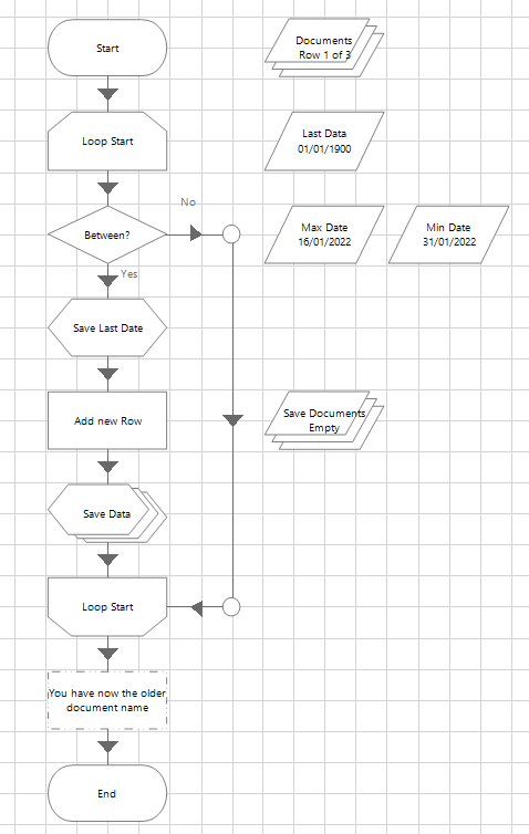

For the second problem,
Similar to the first solution. Now i save the information in a collection, so if you have more than one document, you save all.
- Create two new data items and store on it the maximun date and the minimum date.
- Then, change the Choice decission to this: [Documents.Date] >= [Min Date] OR [Documents.Date] <= [Max Date]

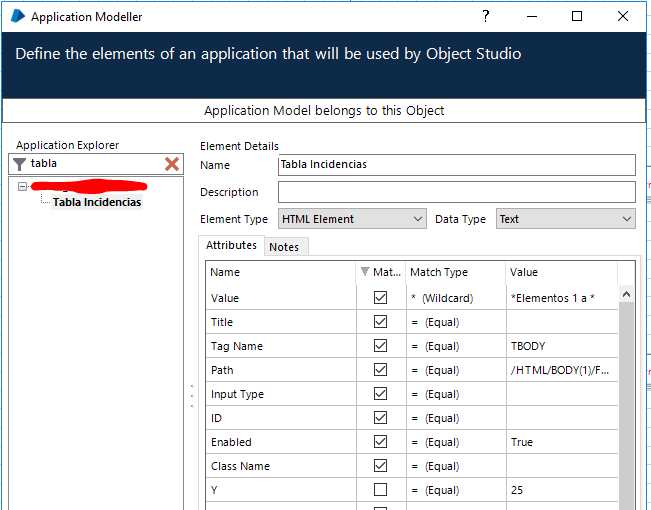

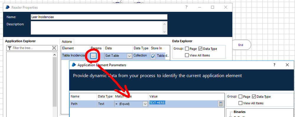

Here you have two optional ways that can helps you
First one! Did you try to spy with the Application Modeller the full table and then, with the Read Stage use the "Get Table" Option?
Application Modeller;
Reader Stage:
Second way... I remember one integrationt that we need to read all links from a similar table, but the "Get Tables" didn't works 😞 Here we use the Dynamic expression for the Path attribute in the application modeller.
If you make this, you will need to make a loop to get all the information. You can also put the calculation to see if is the older document against save all in a collection and then iterating the collection...
One tip for the Dynamic option.... Spy the first and the second links, compare her path attributes to see what change. To use it... in the read stage you need to pass a param. Here you need to write the full path, so you may need to storage in another data item the variable part
Hope this finally helps you. Remember mark the answer as the best if this solve the problem 🙂
Bye 🙂

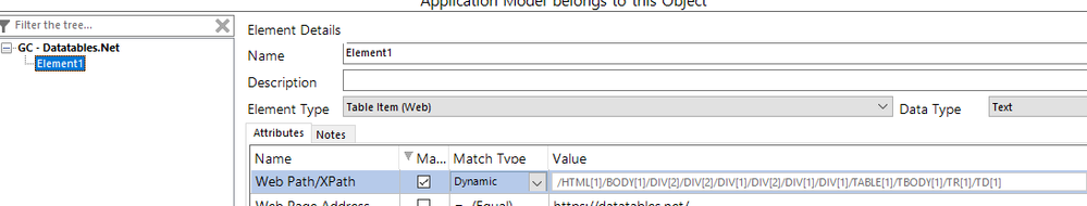

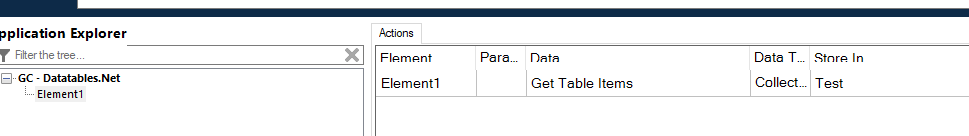

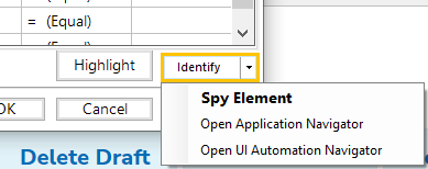

Hi Swati,
I would suggest you to try couple of things to check this. First try to see if you are able to change the Element type of your spied element to 'Web Table' type or not.
If you are got getting the element, then try to see if you are able to view the table element in the Application Modeller for that given element using the Application Navigator which can be access from the arrow besides Identify button:
If you are getting one then you can use the Read Stage and select the action 'Get Table Items' and you should be able to get the table data into a collection.
If the above approach doesn't work then try to spy any of the table element and using dynamic counters, you can traverse the entire table in your workflow.
Here you see I have made the attribute dynamic in the modeller:
And now I can manipulate the path in my workflow by using some incrementing logic with TD and TR counters:
This logic of determining these counter values will depend on the nature of your web table like if there are any pagination involved or if there are footers and headers something like that. Also, remember to incorporate exception handling properly so that in case you do not get any search result as you might have crossed the counter limits, then the bot should gracefully exit the flow.
Once you grab the cells of all the fields for a particular row, add a new row to the output collection which you can define from the beginning with all pre-defined fields and then set up the values in the output collection using Calculation or Multi Calculation stage.

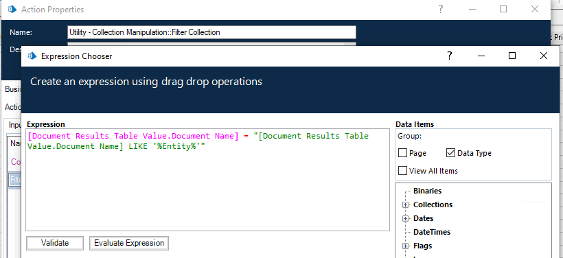

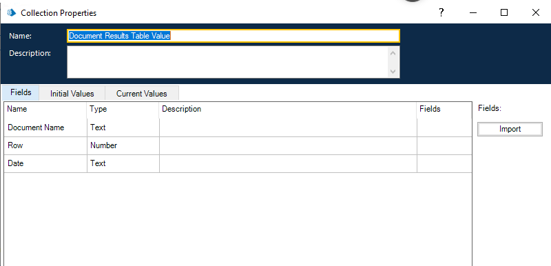

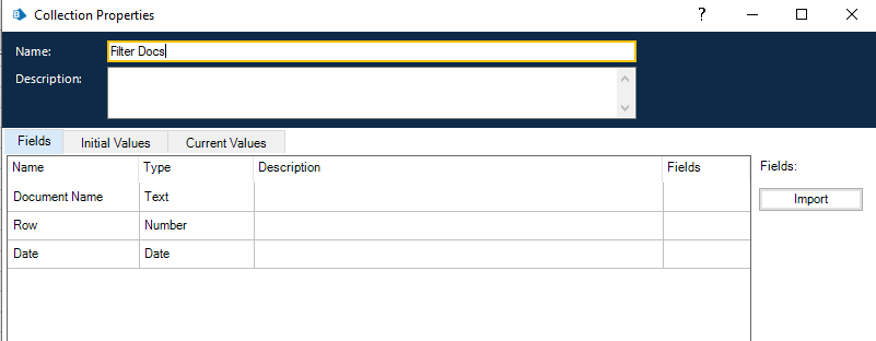

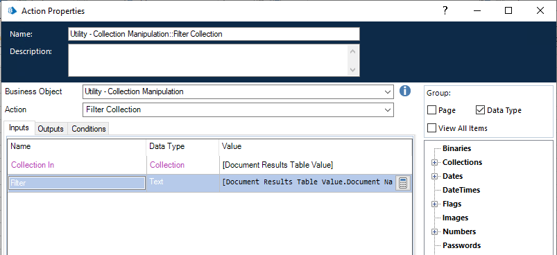

Hi Devneet,
I was using the ways that you mentioned but I am not able to get the filtered collection. Pls see below -
This is my input collection that has all values from which I want to filter.
Then I am using Utility - Filter Collection. I have already created output collection with pre defined fields similar to my input collection.
This is my output collection -
These are values I am giving in Utility Collection - Filter Collection
When I am running this flow, its giving me an empty output collection.
Not sure, where I am going wrong ?
Can you help pls.
Thanks in advance !!
Swati Agrawal
