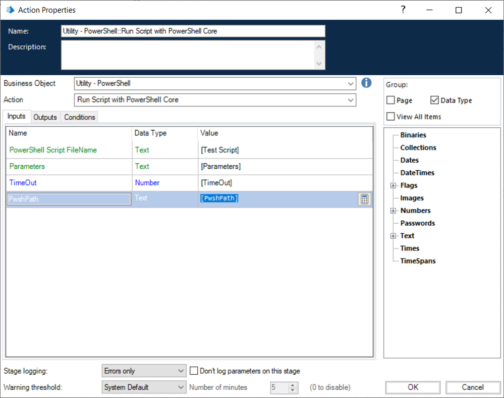

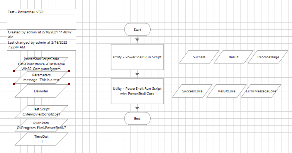

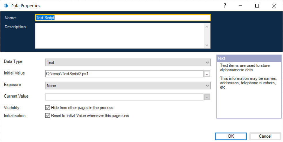

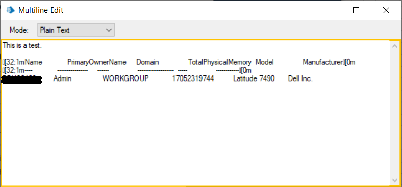

FWIW - Here's an example of passing parameters into a PowerShell script using the Utility - PowerShell VBO that @John Carter referenced. I have a very simple PowerShell script that simply echoes whatever input message has been supplied using the -message parameter. Then it executes the standard Get-CimInstance command. All of the output is then captured and returned as output via the VBO.
If I wanted to pass in multiple parameters, I would need to make use the Delimiter input parameter to specify what custom delimiter I was using to separate my input data. So I might use the pipe character ( | ) which would look something like this with multiple parameters: -message "This is a test" | -priority 3 | ...
Hopefully that helps a bit.
