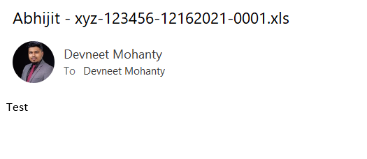

As per your requirement, I sent a test email to myself as shown below:

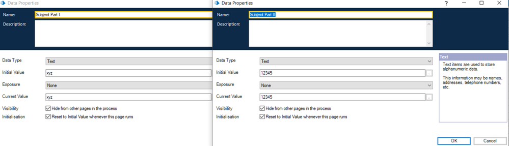

In the Blue Prism end, I am having two data items here called [Subject Part I] and [Subject Part II] as shown below:

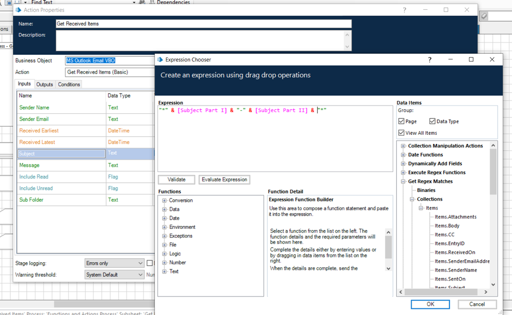

24470.pngI am using the below expression in my subject line:

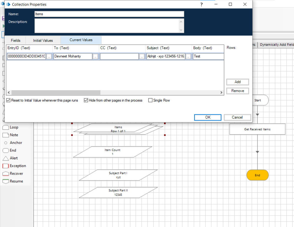

Upon running the solution, you can see the below results:
Please check the expression once that you are using in your subject parameter for the action: "Get Received Items (Basic)"
