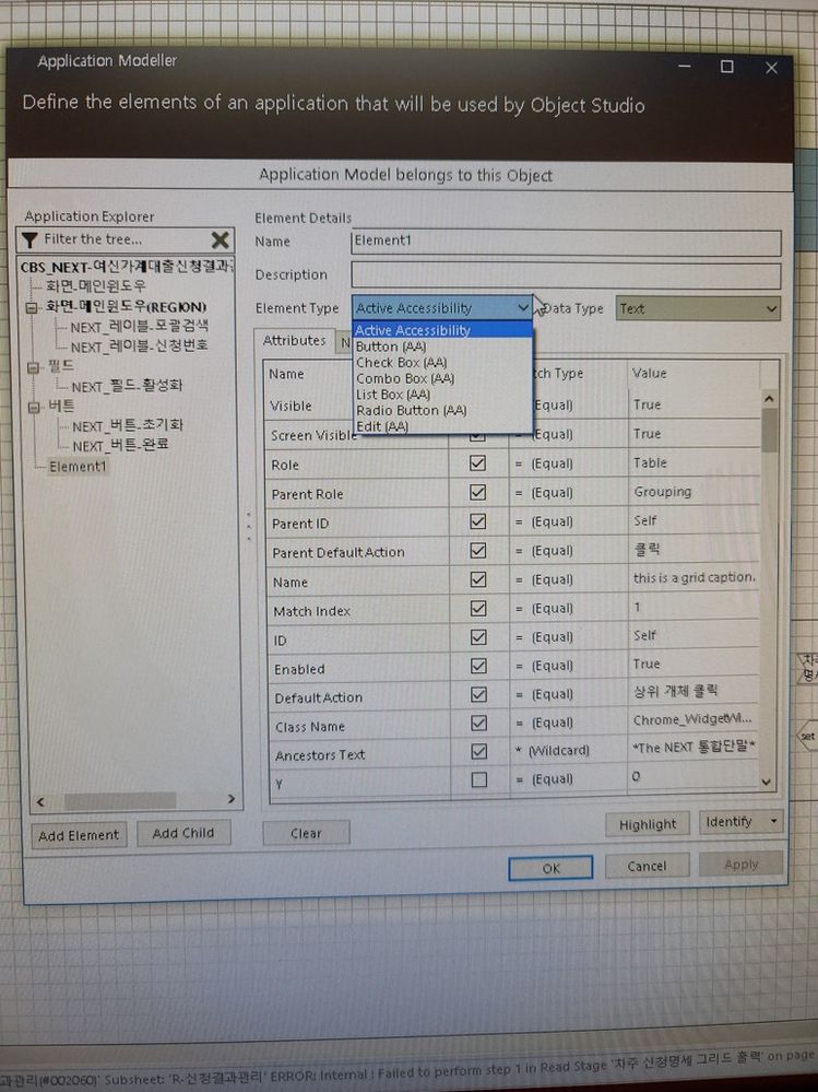

AA type element seems not to have Table type according to the following screen shot captured by our customer.
Is there any way to Read table from the element spied using AA mode?

Hi HongJoo,
It may be that this application (or certain elements, like this table) is not connected through the accessibility layer. Can you try using the Inspect tool to confirm this is an available element, as documented in this KB here?
