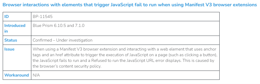

This may be due to new Content Security Policy restrictions introduced for Manifest V3 browser extensions, including the v6.10.5 and v7.1.x Blue Prism browser extensions. This is a known issue documented in the Knowledge Base below:
There are a few workarounds others here in the Community have found worked to interact with these kinds of links under the terms of this new limitation, including:
  • Using UIA Mode
  • Using Region Mode
  • If you can change the links themselves, you can use an onclick action instead of the href calling JS. This can be done as listed below:
  1. Rename the current href attribute to onclick
  2. Add return false; to the end of the contents of the new onclick attribute
  3. Add a href attribute that has the value #
This should result in the current anchor tag of:
<a href="javascript:ProviderSearchScreen();">
being updated to
<a href="#" onclick="ProviderSearchScreen();return false">
