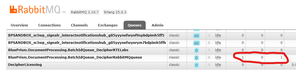

Hi Magnus.
If after clicking the submit button in the Decipher UI, you should see a message RMQ as shown in Ben's message. If that is the case, then using the Get Next Batch function (assuming it is correctly configured) should return the data from RMQ into a collection.
However, if you DO NOT SEE a message in RMQ, then you probably need to reinstall the Decipher Plug-in component. I've seen this issue a couple of times with customers where there was a problem with the Decipher Plug-in installation. Once it was reinstalled, the issue was resolved.

Hi Magnus,
Can you see any messages in the RabbitMQ queue? (see below image)

Hi Ben/Jack,
There were no messages in the RabbitMQqueue which explains why I'm not getting any. But after reinstalling the Decipher Plug-in, it is now working (maybe because we also did the whole re-installation of all components). Anyways, thanks for the answers. You guys are awesome! 🙂
