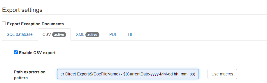

If you are exporting csv then you can append the original PDF name in export. See below. I generally use this way to track the file name.
C:\Decipher Direct Export\$(DocFileName) - $(CurrentDate-yyyy-MM-dd hh_mm_ss)
Thanks & Regards,
Technical Lead
Worth noting this would need to be in a folder the account running the web client (likely a service/system account) will need folder access, as will the person/digital worker looking use the file.
