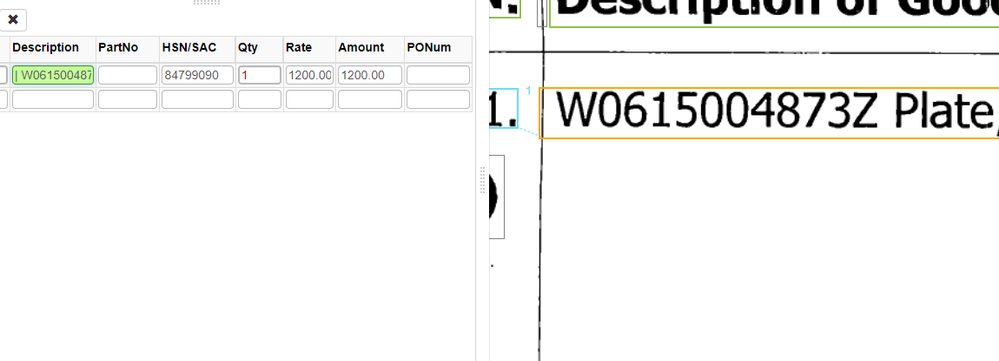

Decipher issues with recognizing table lines
I often face this issue where Decipher extract table lines as "|".
I wonder why it is not able to recognize the table structure lines and instead extracting values with "|" pipe characters.
And this is happening for all types of invoices. Sometimes it takes pipe, dots, semicolumns etc for the table lines
Is Decipher able to understand the table structures? Here, it looks like going only with the sample headers.

No this is the raw output without training and the table lines are clear and consistent

If I fix for 1 line item then it still keeps doing for other lines and other line fields.
There is no vertical column division per say in Decipher line item extraction. Sometimes it combines 2 line fields in 1.

Using a format expression will just clean up the data after extraction is performed, right?
Will it make Decipher understand the table lines?
