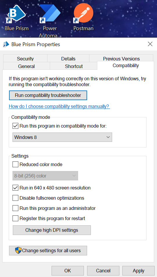

Hi @Barbara Sanchez
You can check the compatibility settings once on your machine for Blue Prism Interactive Client software:

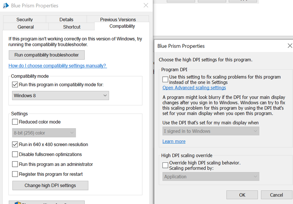

Also, if you click on the Change High DPI settings  you can change some of the parameters to see what works best for you:
In my case also, the same issue happened as I am using Lenovo Legion 5 Pro machine which has a default resolution of 2560X1600. But after tweaking the settings for a bit I got a proper scaled up result.
