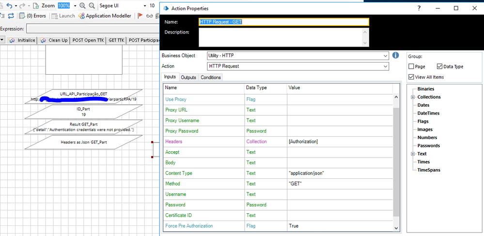

Good morning,
I´m having trouble using the Http Request VBO  with Method "GET", i am passing the the Authorization on the Headers,  but still gives {"detail":"Authentication credentials were not provided."}, with the POST method it works fine.( I tested using the the POSTMAN and other API testers and they all worked.)
EmersonF
Try passing credentials in the user and password fields, and see if that works for you

TusharVarshney
Hi, you could try making  force pre authorization false, and if that too doesn't work provide the credential as user name and password in relevant field.

JoãoSilva1
Thx guys for the inputs, about the User and PW, but the api doesnt have that its with token that they gave me.
But i finally resolved the issue, on the URL when i send the the ID to do the GET i need to put the "/"   URL/ID/, if i dont put the "/" it doesnt work, a bit strange it should work whitout the "/".
