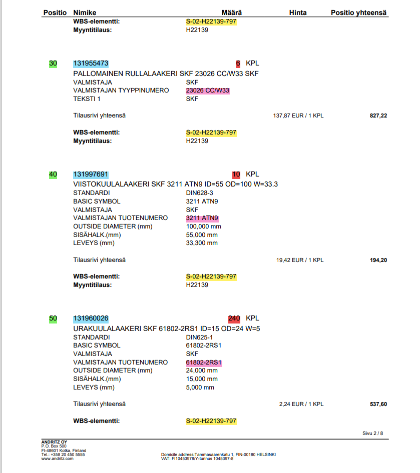

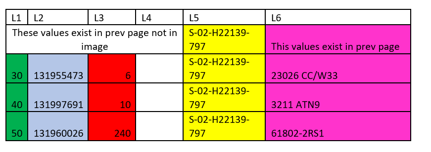

Here with I have attached image(source data) , image2 as
expected result is as shown in table
I have colored the values in the image with same colors of below table , for better understanding.
I have trained around 30 + docs and results are not satisfactory.
- The columns L1,L2 L3 comes exactly across even for multiple pages
- But L5and L6 lines are not coming properly almost for all lines
- The data in the image, you can observe that it is more unstructured data ,
- Coz L5 and L6 column values present in the image in different rows
- I have added key words which present for L5 and L6 values in the image still result is not good.

Hi Krishna,
1. NLP is not intended for structured or semi-structured documents, and while I appreciate this may seem "unstructured" it would fall in one of the first 2 categories. This is because the information is laid out in a consistent structure and not unstructured like a contract or agreement.
2. The GPU requirement is to speed up the processing as the NLP model uses a neural network and a regular CPU would take far too long to process the data.
3. Without anchors (e.g. sample headers) near the respective data, it will be very difficult to train consistently. Your best bet is to try using Format Expressions (Regex) for each of the fields. Sometimes you may need to gather more data than needed and format it later in Blue Prism. e.g. get the number 10 and KPL, then remove KPL later.

as you said in #3 , I am doing lot of enrichment in BP process. But here problem is the expected value position line is keep changing (mean that it present 4 or 6 ot 9 row of specific order line) .
This is causing for Decipher to get wrong value as it remember last trained row position . to pore precise
Assume I trained D1 and picked the data from 4th (sample header as VALMISTAJAN TUOTENUMERO) row of an order line (say for 30 line).
for next order D2 assume same header present in 6th row , it won't read 6th row data still it read 4th line data
Hope i explained clearly 🙂

17-09-21 09:52 AM
Hi Krishna,
You might be better off reading the entire section of text, then using formulas/functions in Blue Prism to extract the specific data.
