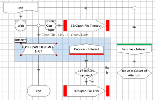

We are using BPC version 7.1.2 and these automations have been working fine for at least that last 12 months (in some cases 2 years).  We click on a link after downloading a file, as per this example:
Using something similar to this automation:
As you can see, if the Link does not exist, we Time Out. If if we can't interact it with we have a retry loop but then ultimately raise an Exception.  In all of the terminations, this page has completed (on the 1st cycle) and not raised any errors.  The process therefore assumes that Excel is open and thigs can continue.
