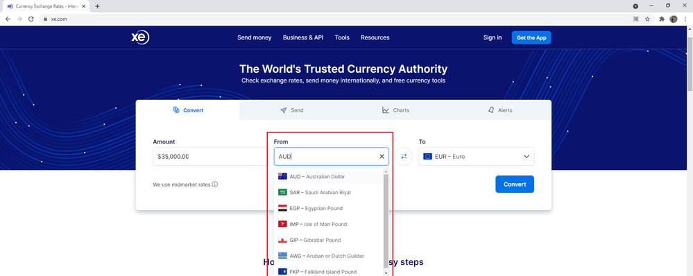

Dear everyone,
I'm a newcomer with Blue Prism and I have an issue that needs your help. How can I set value for the input textbox - search in Chrome at the website "https://www.xe.com/" as below:
I've tried to find solutions but not any so far. Could anyone suggest me any? I appreciate that.

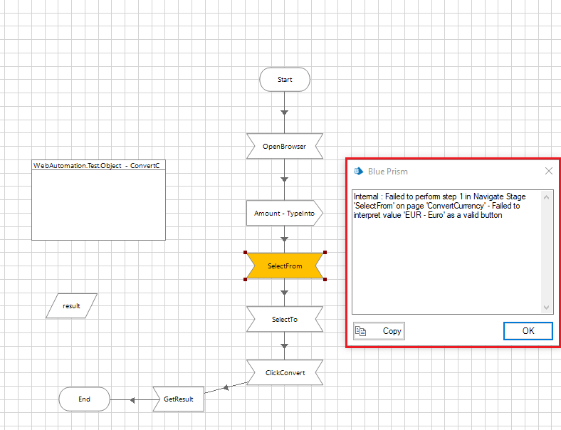

Hi @ritansh.jatwani,
I have tried using Global Mouse Click but I always see the error as below.
14462.png​

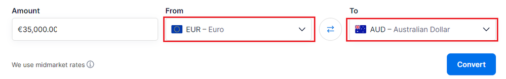

I have checked the element Html and see that From and To are not the dropdown list, they are just text boxes, when we type texts into them and press Enter, the corresponding texts will be filled.
So, is there any Blue Prism activity or a way for Bot can do as simulate as humans do?

Huy Chenh
HI @Huy Chenh,
Absolutely, using Blue Prism you can imitate exactly what humans are doing.
For achieving your requirements, i would prefer you performing below steps:
1) Spy "From" and "To" textbox using either AA/UIA mode​. The reason for spying with these 2 modes is that you can get "Global Mouse click center" functionality with these 2 modes.
2) Using Navigate stage, perform global mouse click center (and not Global Mouse Click). This action is similar to humans performing click on the textbox.
3) Using Navigate stage, select Global Send Keys and pass the value which you want to select. Post that you can pass either "Enter" or "Tab" using Global Send Keys  to select the desired value.
Please let me know if it still doesn't work.
Consultant
EY
Gurgaon
