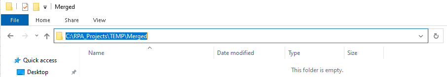

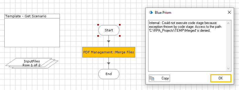

I'm trying to execute the "Merge Files" action, but I'm facing the following error.
Should I do something else besides this: "Copy "PdfSharp.dll" to the Blue Prism installation folder "C:\Program
Files\Blue Prism Limited\Blue Prism Automate""?
Thank you in advance.
Luis Canales
01-12-22 01:43 PM
That error seems to indicate the robot doesn't have permissions to access the target folder. I'm assuming this is where you're trying to write the newly merged PDF?
01-12-22 05:13 PM
It's working now, thanks for your help!
