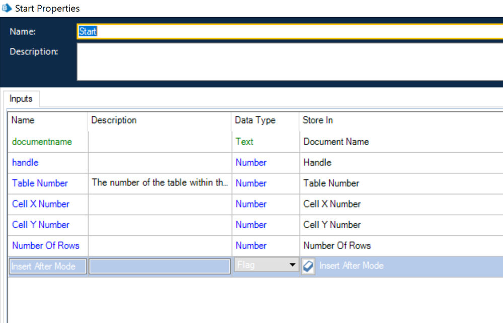

In order to achieve this, we can extend the "MS Word VBO" by creating a separate action within it and you can call it as "Add Table Rows At Position". This action will be having the following input parameters:
  1. Handle (Number) : The data item having the handle value in the instance dictionary that needs to be queried. (This you can get from Create Instance action)
  2. Document Name (Text) : The document name of the current workbook which the Blur Prism bot is operating on. (This you can get from Open Workbook action)
  3. Table Number (Number) : The table element index used in the current workbook to identify the table.
  4. Cell X (Number) : The row number of the cell which will be considered as the reference for deciding the rows to be added below or above. (The index value starts from 1)
  5. Cell Y (Number) : The column number of the cell which will be considered as the reference for deciding the rows to be added below or above. (The index value starts from 1)
  6. Number Of Rows (Number) : The number of rows which need to be added below or above the reference cell. (The value should be greater than 0)
  7. Insert After Mode (Flag) : The flag value determining whether the rows need to be added above or below the reference cell. (If the value is True, rows will be added below the reference cell otherwise the rows will be added above the reference cell)

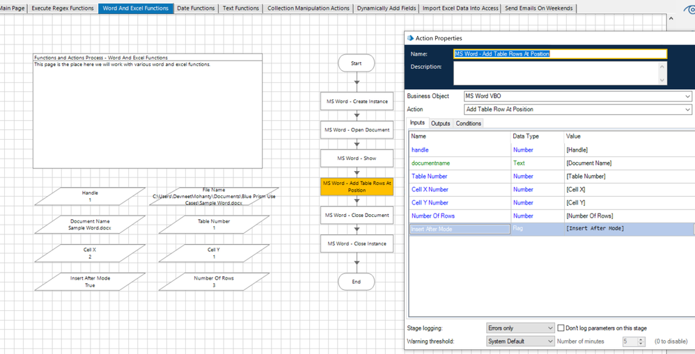

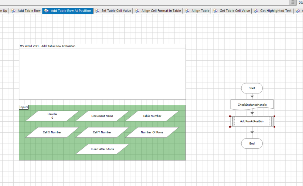

Refer to the below workflow for more information:

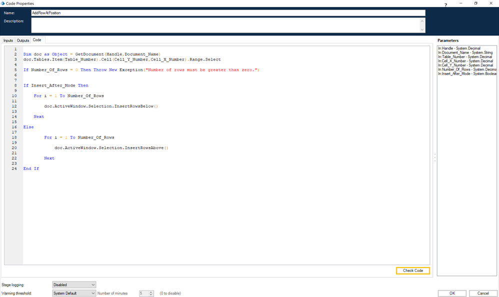

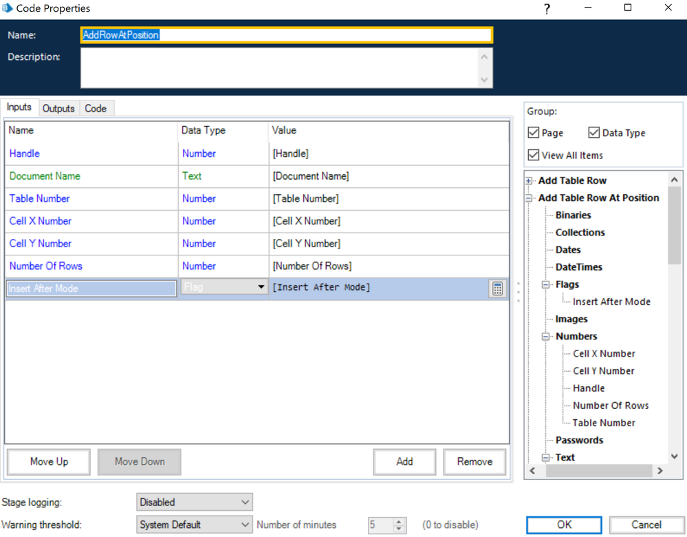

Now, add a custom code stage with the following Input parameters and the code as shown below. No output parameters are required:
Code:
Dim doc as Object = GetDocument(Handle,Document_Name)
doc.Tables.Item(Table_Number).Cell(Cell_Y_Number,Cell_X_Number).Range.Select
If Number_Of_Rows = 0 Then Throw New Exception("Number of rows must be greater than zero.")
If Insert_After_Mode Then
     For i = 1 To Number_Of_Rows
        doc.ActiveWindow.Selection.InsertRowsBelow()
     Next
Else
         doc.ActiveWindow.Selection.InsertRowsAbove()
     Next
End If
You can publish this action and run the same from Process Studio to check your results.
Some of the test results are shown below:

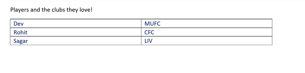

Scenario I: The table I have has three rows by default and I want to add three rows below the second row:
Result of the action is:
