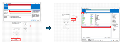

  • Open the SMTP/POP3 business object and make a copy of the action - 'Send Email' and you can name it as 'Send Email With Multiple Images' as shown below:
  • Now, add a collection called 'ImagePaths' with a field value called 'ImagePath' of text type and add it as an input argument to your code stage as well:
  •  Now, in the code tab enter the following code:

Main difference in this code is that, instead of one image path we are iterating over the collection of image paths and setting up an array of LinkedResource objects based on the number of image paths provided.
Then, each of these objects have a contentId which is getting appended to an HTML string with an adjustable width so that they do not span all across the email body.
Finally, we create an alternate view out of these HTML strings and then the LinkedResource objects are also added to the alternate view as well.
