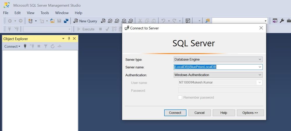

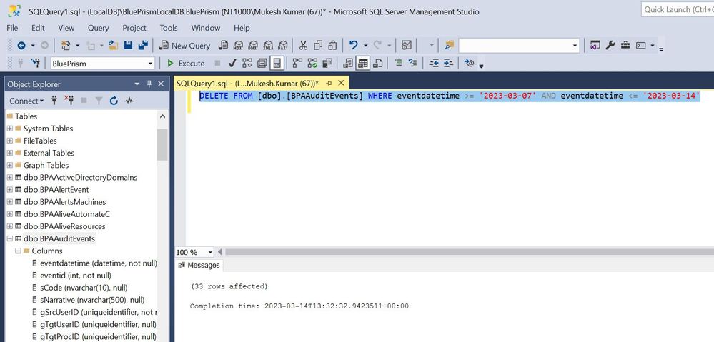

Hi @Tejaskumar_Darji , I am afraid I could not find any such options to delete the audit logs from within the system tab and as you rightly mentioned the System Tab> System > Archiving only deletes the Process and Objects logs but not the Audit logs.
It seems we are left with one option only and that is to Delete the logs via SSMS BP Database with SQL Query as:  DELETE FROM [dbo].[BPAAuditEvents] WHERE eventdatetime >= '2023-03-07' AND eventdatetime <= '2023-03-14'

I was able to clear the Audit table from DB using the query mentioned above by Mukesh.
A quick note if anyone performs this in the future. Ensure you take a backup of all your BP stuff before doing such direct DB actions. Thanks.
