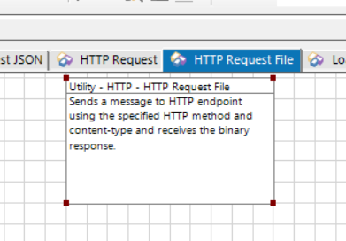

The Web API service feature does not currently support downloading binary data. It only supports textual data. To download a binary file (ex. PDF, ZIP, etc) you can use the latest Utility -HTTP VBO (available on the DX) or write your own code stage.

I read the guide for HTTP VBO and Im not able to find any reference to get output as Binary, I can see all the request output types are set as Type only.

@Sheela Parthasarathy,
That is the correct VBO. There is an action on it called HTTP Request File which can be used to download a binary file.
