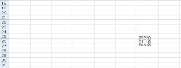

Hi all,
How to get checkboxes value and their location in excel ?
I tried MS Excel VBO::Get Worksheet As Collection,but get noting.

19-12-19 04:39 AM
Hi Lisa,
Every control in Excel is an object to find the objects in excel sheet follow the below procedure
Go to Home –> Editing –> Find & Select –> Selection Pane.
Sub CheckboxValue_Method1()
Dim cbValue As Variant
cbValue = ActiveSheet.CheckBox1.Value
End Sub
Note: Replace CheckBox1 with your object name
Naga
Associate
Asia/Kolkata
- This will open a Selection Pane that will list all the objects on that worksheet (including checkboxes, shapes, and charts).
- The names of the checkboxes here are the backend names.
- Once you got your required object, write a VBO or macro to get the status of the object and trigger the same from Blueprism.
End Sub
Naga
Associate
Asia/Kolkata

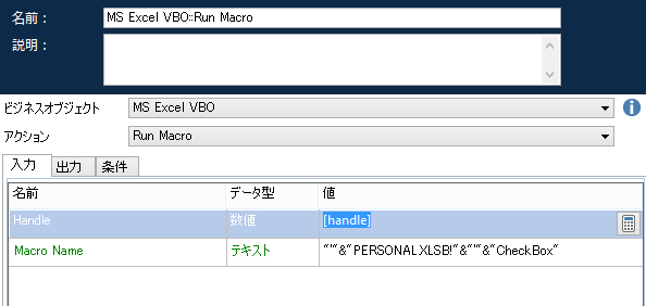

19-12-19 06:11 AM
Thank you very much for your answer, Naga
I writed a macro to get the status of the checkbox.But I encountered a little problem when running it on blueprism.
lisa li
My macro name PERSONAL.XLSB!CheckBox.I can manually execute it successfully.
Can you help me
But I got an error reminder when I run the Run Macro via blueprism.
error message:The code stage could not be executed because an exception was thrown by the code stage. The macro '' PERSONAL.XLSB! 'CheckBox' cannot be executed. Macros may not be available in this workbook, or all macros may be disabled.Can you help me
lisa li
20-12-19 03:59 AM
2 Options:
1- Either Change the macroname to be a simple name without special characters
2- Just pass the name as it is "PERSONAL.XLSB!CheckBox" nothing else.
Vivek Goel
RPA Architect
Asia/Singapore
https://www.rpatools.com/
Vivek Goel
RPA Architect
Asia/Singapore
23-12-19 12:56 AM
Thank you very much for your answer.
I solved the problem.
lisa li
lisa li
