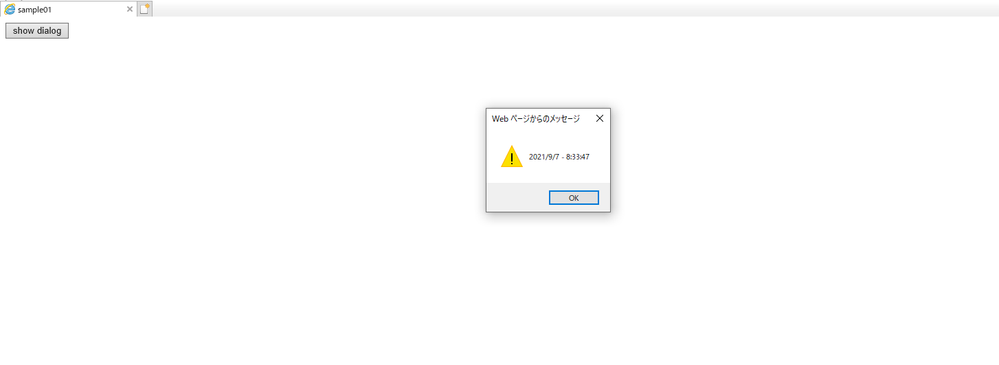

If I view this in IE;
22099.pngThis dialog can be detected by the window handle "#32770", so I can retrieve the dialog message and press the OK button.

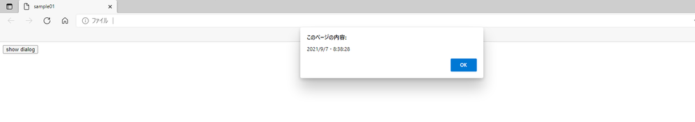

If I view this in Edge;
22100.pngHow can I detect and manipulate this dialog other than surface automation?

It might be best to create a second object to handle the pop-up. In App Modeller choose the 'windows application' and 'attach' options, Just give window title & child index to attach to the popup OR Put it to foreground Send a specific key combination to click it away.

I believe alerts are passed through to the browser to render and that when Chrome / Edge / Firefox render alerts they do so in a way that is typically only accessible from Win32 or UIA as the alert modals themselves are not html based. If you don't have the launch argument specified to allow UIA rendering on the browser's part you may not be able to spy using UIA mode. (something like --force-renderer-accessibility)

I can spy alert using UIA, but cannot spy the message in the alert or press the OK button.
When manipulating alert in IE, I create a separate object to operate, but in case of Edge, that don't seems to be a solution.​

You are right @sumire you can not spy as you spy in IE. So you can just spy the window and use close window in Navigate button sometimes it work​s other wise just activate send Enter. I handled it on the same way in Chrome browser.
