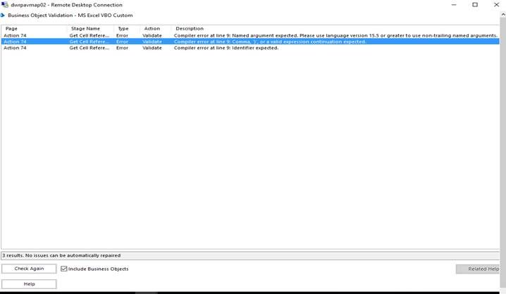

Hi Nupur Sood,
I tried the below code for finding the cell reference ..But its shows the below error:
Can u help me to resolve the issue?

Hello Janani
Am not sure why are you getting these errors because the code works fine at my end. Would you be able to add a screenshot of your code stage please.

Please find the below screenshot of the code stage which I used in my blueprism.
Janani PR
Get rid of the underscore - that's the continuation separator that Nupur used to split the code onto 2 lines. You have it in one line, so get rid.
